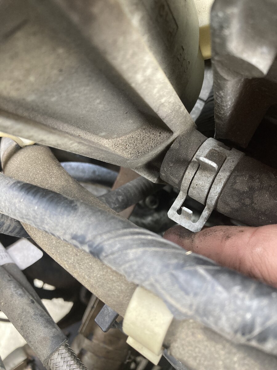

Well, when it rains it pours, I guess. My Mounty (1998 5.0) has an AC line that’s twisted up. Only thing I can think it that it was replaced by a garbage mechanic in the past. The line pictured needs replaced. Is this going to be something I can do myself? I have access to gauges and a vacuum pump.
This is where it’s kinked:

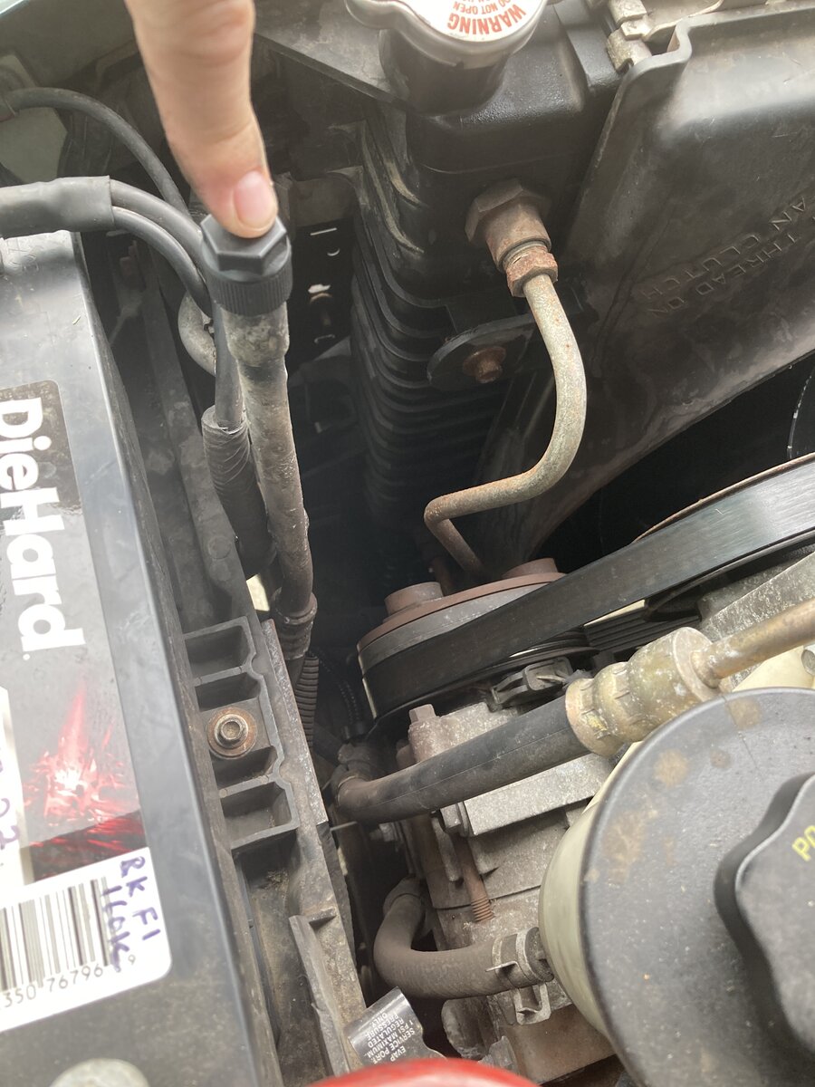

After messing with it it blew a bunch of Freon out of where it attaches to the compressor here :
Now, I’m afraid to drive it, after dropping over $500 in maintenance on this turd. I’m gonna pull the relay so the AC compressor doesn’t run. There’s still pressure in the system, although I didn’t try and drive it yet. How screwed am I?
Should be okay IMO
you need to change that line which means evacuating the system, change the line, vacuum the system, leak check, then re charge
You can also simply unplug the clutch on the compressor, or pull the fuse/relay
I guess I’ll try and hit the pick and pull today or tomorrow. The AC has been lackluster, despite the normal checks, such as the vacuum coolant valve, the blend door seems functional, I was wondering if this was the cause. I wish I had just left it.
That’s the HP line. Not too bad to change.
It’s actually decently cheap on RockAuto, too. Make sure you get some new green seals, regardless
Maybe I’ll just grab it new. I was afraid of driving and losing all the charge. I’m certainly not going to replace the compressor on this.
When it blew out it I thought it was coolant at first.

Where does the other end of the line go? One end goes to the condenser, there is a tap that bolts to the compressor, and then there is another end connection I’m not sure where it ends up.
Accumulator/drier. Should be the threaded connection, IIRC
