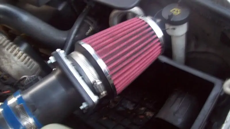

if you're good at fabricating you can get maybe a 14 inch long piece of metal and some sort of half circle, either a piece of metal or big PVC.
the metal can be screwed in one of the screws holding up your alternator or whatever is close by, it should have washers so you can just remove one of the washers in place of this new metal.
Bend the end of the metal and screw through the PVC positioned under your CAI.
That's a nice home made way of making what K&N gave me for my intake.
only difference is mine is a 4.6 V8, so the positioning is slightly different but it's the same concept really.
Another modification would be to box in your new intake to keep it away from your hot intake temperatures.
This can be done with metal or plastic shaped around your air filter.
Just to show how much cooler air helps your engine, my intake runs behind my right headlight. My programmer shows intake temps:
With my headlight in, in MIAMI weather.. the air temp was 98 degrees and dropped down to 94 degrees in motion.
with my headlight removed, letting cooler air to be rushed in directly onto my K&N intake.. the air temp was 92 degrees dropping down to 83 degrees in motion.
That alone changes my 1/8 mile drag times by .100 of a second.
I dont have my intake completely sectioned off from the engine, but i do have the included shroud from K&N, minus the gasket which fell off =(
