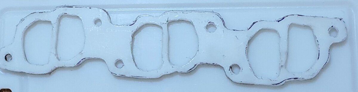

Thank you very much for the reply and help.
The mechanic will use a 10mm spacer.
Looks like he paid a rat to chew that spacer out of a sheet of plastic. Why does it look so jagged?
I’d bet there are spacers you could just buy.
That spacer looks almost exactly like what is already in there under the fuel rail.
Could you modify a factory fuel rail gasket/ spacer
There is plenty of room to do what you are thinking however you might need to source some longer intake studs
I don’t like the idea of doubling those prone o-rings. Why does the intake need more height? Is there any other way to correct whatever issue there is?
