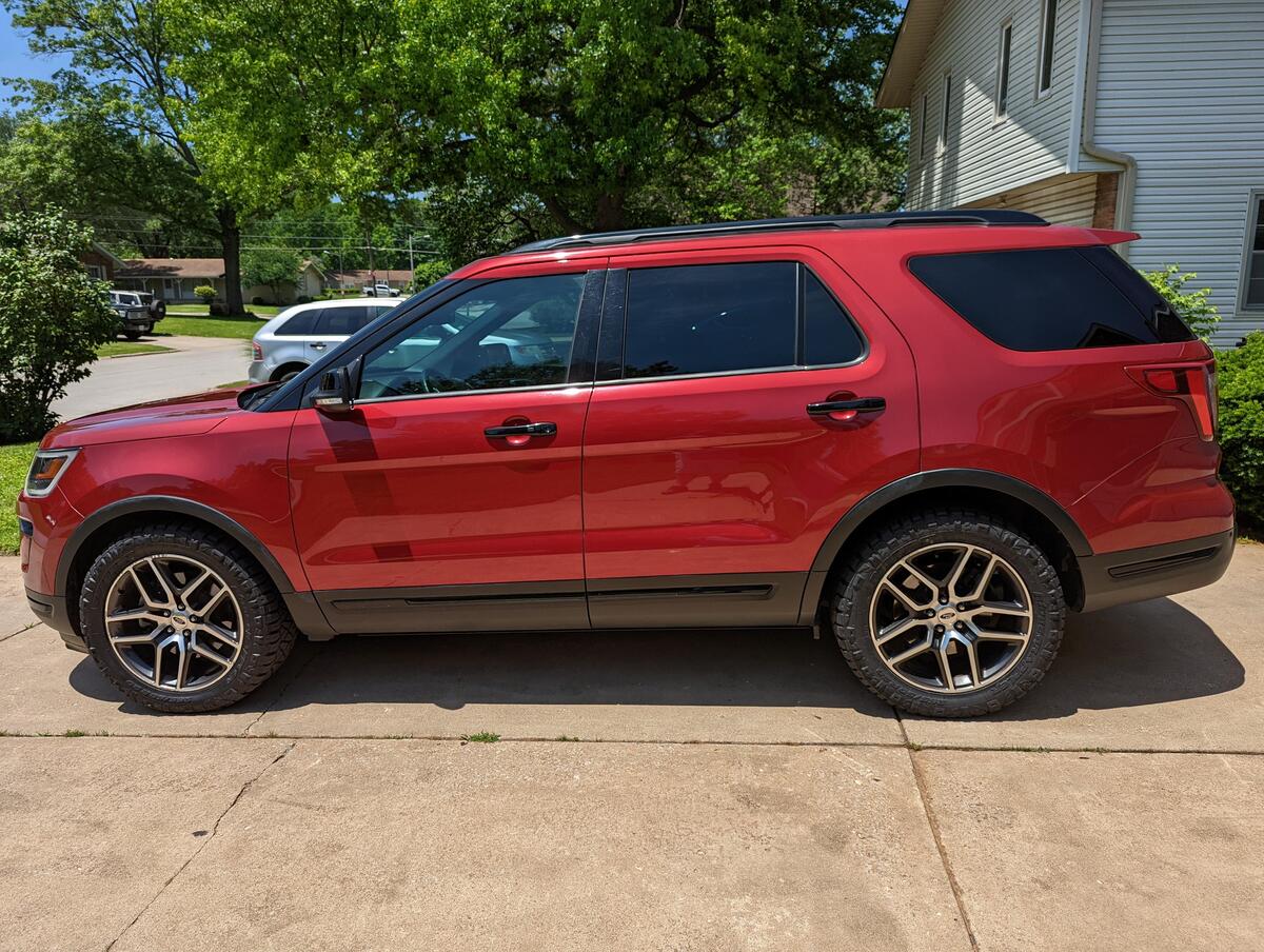

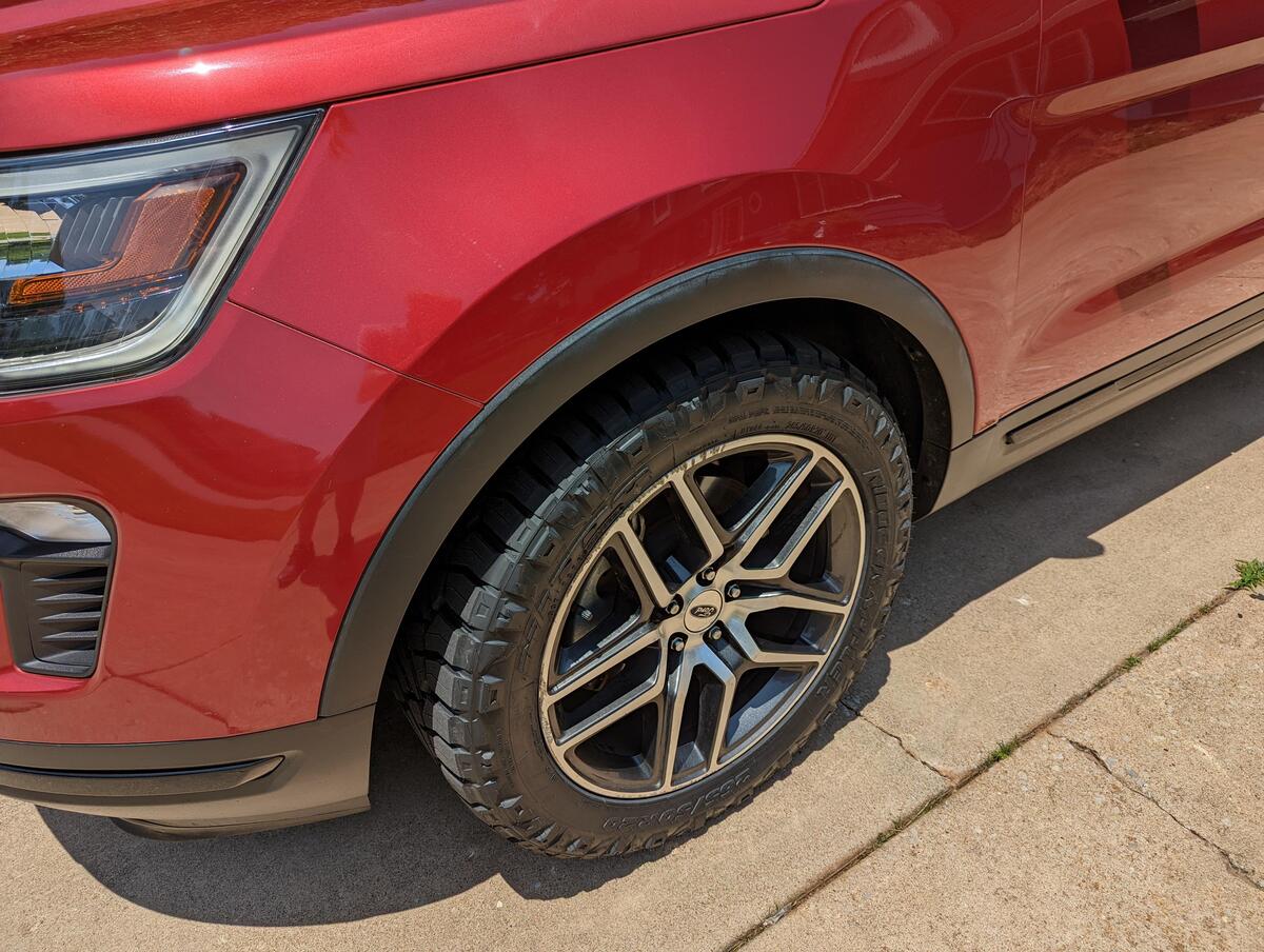

I had NITTO Trail Grapplers on mine in the same size 265/70r17 until they wore out, and with the size of the tread, I would have rubbed if I went any bigger. Right now I have Goodyear Wrangler Ultra Terrains. And I could probably get away with a 285/70 due to having a 4.5 inch backspace but the price goes up with the tire size lol.
