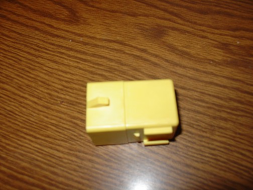

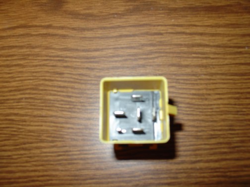

Yes, it was indeed the flasher. Ford has replaced simple flashers with an electronic one that not only controls the turn signals but also the hazzard lights. Further, they are real proud of the flasher, part number F67Z13350AA and is $34.75 plus tax.
The flasjer is indeed located where the post Bill Kemp made said t was. Its a pain in the arse to remove the panels to get to it.

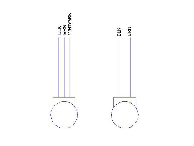

I decided to make a few diagrams to show simply how this is done. Note wire colors are for at 1996 Explorer. Wire colors may vary on yours, but the principal remains the same.
First, here's where the bulbs are located. You will be attaching the wire from the one labeled "corner" to either of the ones labeled "turn"
Once pulling out the corner lamp assembly, it is simple. I did this in less than 10 minutes start to finish.
Driver's side:
This shows the wires going to the corner marker bulb (2 wires) and the turn signal (3 wires)

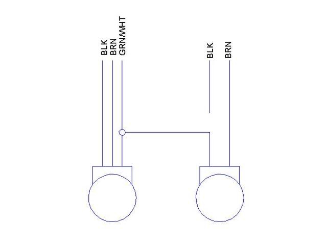

Now, simply cut the black (ground) from the corner bulb and splice it into the green wire w/white stripe.
(driver's side after)
Passenger side:
Same as driver's side, but the turn signal leads are different color. Instead of being green w/ white stripe like on the driver's side, it is a white w/green strip wire. That's the the only difference.
After:
It's very simple to do. You may also wish to cap off the loose ground wire that used to connect to the corner bulb. I'm not sure if leaving it open would cause any problems, but I just capped it anyway, just in case.
