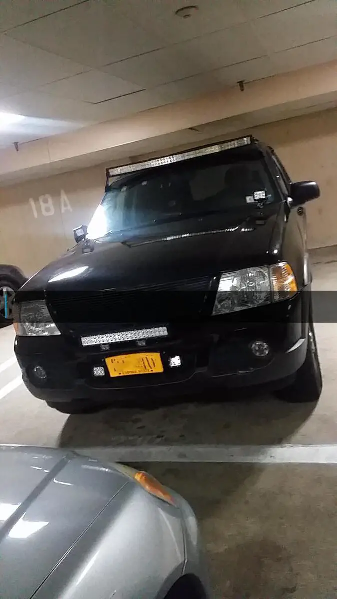

@mcclain61 How much hood glare do you get at night with the bar on the front like that?
mcclain61
- December 7, 2013
- 123
- 8
- bristol tn
- 2004 explorer
Before I tinted 5% down to the rear view mirror it was quite a lot, then I moved it back a little and tinted the windshield down to the mirror so now it's not bad at all
it turns night into day lol only 288 watt auxbeam 52"
I'll try to see if I can get a night pic next time I'm out

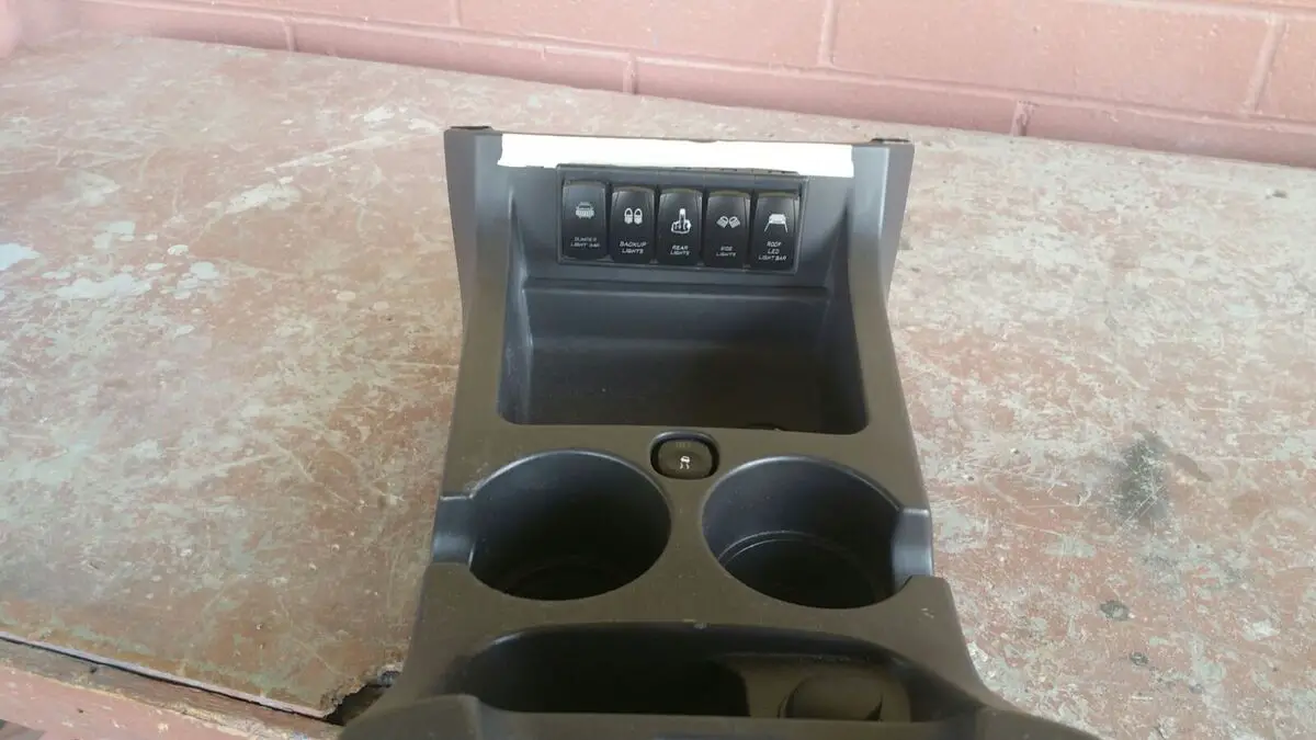

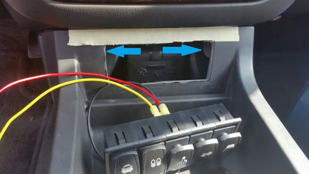

It's important to note that unless you further modify your center console a 6 switch panel will not fit due to brackets behind it. I now have have to 3D print a panel that will snap in but give clearance for all 6 switches.
what?!?!? There is no bracket back there. The problem is the curvature of the console itself.... and if they arent connected like mine its not an issue. Admins, is this guy a bot or something???
Unfortunately there is a tube in the way, and no possible way for this to fit with out further modifications. Also that metal bracket that doesn't exist is in the second picture and prevents the switches from sitting in the console nicely.
@SPSully Any advice about what to do with that middle plastic piece?
sorry about the delay. Mine dont fit exactly flush with eachother because of the curve. Also, bend the prongs angled down or up to give yourself a little more clearance.

Ye I understand that part but more that there are metal rings in the way back there. Left side is hard to see but you can see the right side. Also what is the best way to get the wires out of the firewall? Just poke a hole in the driver side grommet thing?sorry about the delay. Mine dont fit exactly flush with eachother because of the curve. Also, bend the prongs angled down or up to give yourself a little more clearance.

https://www.amazon.com/gp/product/B01EWRZ13MAwesome, thanks! It looks like there's some type of housing you're using too, to hold all the switches. Do you have any info on that part?
It's important to note that this will not sit flush against the part of the car in the picture, the car part is slightly curved like what SPSully said, if you're a perfectionist this probably isn't the right thing for you since you can tell a bit since you're looking down at that section when its all installed. Also Idk what I'm going to do about the metal "ears" there. I guess grind part of it off since I've already taken a heat gun to the HVAC tubes and melted / pushed them back to make them smaller and more out of the way.

4 will fit flush.
I had no issues with any metal rings. not sure why you are.
As for power. I ran a fuse panel under the arm rest but inside that same part of the console (think behind the cup holders) and have tapped all of my power from that panel. The power to the panel is fused with one of those big car audio type fuses and then each circuit has its own blade style fuse. Sorry, but I dont have pictures.
