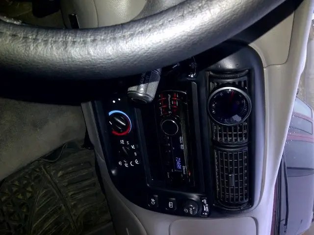

I mounted my boost/vac gauge. Pretty easy, really. I'll see how it works out.

What gauge is that?
your hooking it up after blower right?witch leads me to the next question or point,how are you hooking up you fuel pressure regulator?i think it needs to be after the sc also.from what i understand when there is vac it lessens the pressure and when there is no vac it increases fuel pressure.so only place that happens is after the blower right?before the blower it should be creating vac ALL the time now

My boost/vag gauge is pulling from post SC. I have a nipple already installed. Ron at RPCaster had drilled and tapped a line for me.
