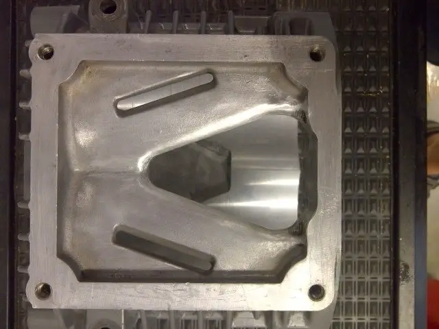

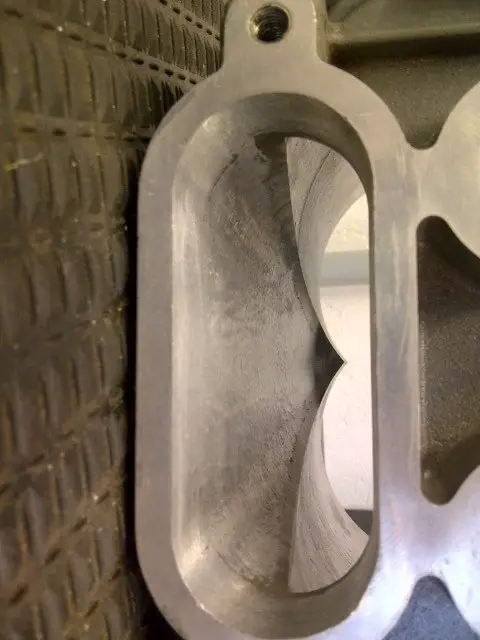

M90 porting
Here it is.
I couldn't do much on the intake side unless I want to work with the intake manifold also.
On the exit, the only area that could touch the blades I changed was at where I changed the bolt housing.
Other than that, I just radius'd the edges out. Here's a couple pics.

Looks good man.not to drastic,clean and larger.should help alittle.how does your blades coating and inside the charger walls look?
I think my M90 is too old to have a epoxy coating on the blades. I don't see any coating at all.
The walls of the case are a bit scored up, but I don't want to touch the walls at all, as this will remove material and increase the gap between the blades and the case.
The scoring isn't too bad. I see far worse pictures on the net (For what that's worth).

I looks super clean is why i asked.mine has soooo much carbon build up its crazy.i can still see some coating on the blades.oo yea dont touch those inside walls it would make it worse.
Mine had no carbon on it at all. I don't know the history of it though. I do know that the last time the snout was taken off, no sealing material was used on re-assembly though. Maybe it was cleaned, new oil fill, and not used?

Could be,maybe whatever was used to clean it also took the coating off the blades.not having any would worry me:(
If my m90 gives grief after install, I wont have much choice but to fix it. Maybe I'd be able to get an exchange on the blade assembly somewhere.
I do know the early versions of the supercoup m90 didnt have a coating on the blades from factory though.
What really??i didnt know that,swore all blades had some sort of coating.i wouldnt think they would be as efficient as a coated unit.i know for the 3800s they made all with coating and each gen had better coatings and it made a difference
I think your right on them not being as efficient. Or maybe I was reading information posted by a guy that had no idea what he was talking about. I'm not sure.
I'll have a closer look at my blades for signs of a coating, or a coating that once existed.
