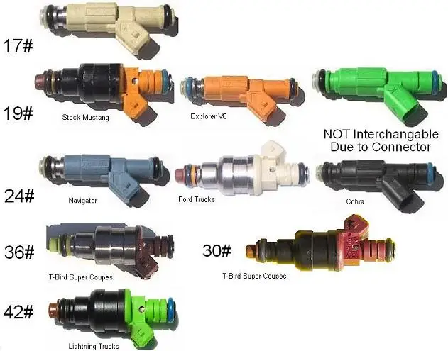

Red should be 30lbs.glad you brought this up now because I bought what I though and was advertised as 36Lbs but I know for 100% mine are green which normally is 42Lbs.I was tuned to 36Lbs so wonder how thats working out:(
DON if you ever get a sec can you check yours to see what color they are, if you can see them or have a old pic.
19Lbs on left and what I thought was 36Lbs on right
Where did you find that pic on injectors? It is wrong. Thunderbird turbo coupes had the brown top injector, 89-93 Thunderbird super coupes had red top injectors and 94-95 Thunderbird super coupes had blue top injectors.
And they sell an adapter of the one that has the wrong plug.
LOL haha.

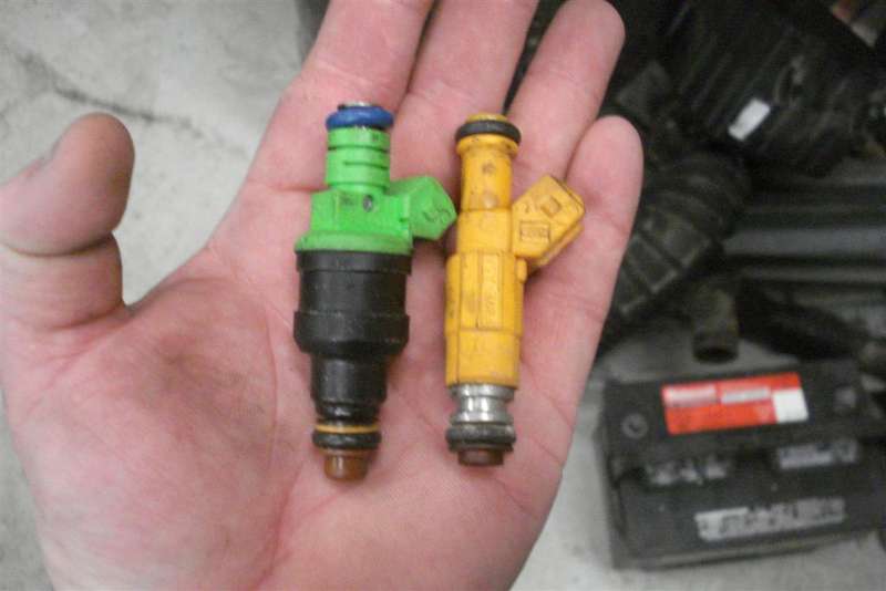

Yea it appears that you cant go by the color. ..because mine are green and they came out a thunder bird supercoupe:eek: lol I found the part number on my flow sheet plus it shows right on there what they flowed haha:D
It sounds like the injector thing is sorted out, but I'll still look for an injector (James sent me ones out of a v8, so I have 2 laying around the garage somewhere) and take a picture.
Im sure I'm not leaning out, or at WOT, Id see my a/f ratio go high. 36's seem to be ok for my motor.
