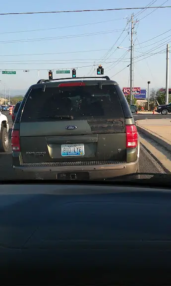

gotta love ford there partsman .... you pull the panel off and you can see right into ur hatch area lol what a design!!

Here's the what the back side looks like. Sorry, I just couldn't help myself. Took this pic a few weeks ago in Pigeon Forge TN.
