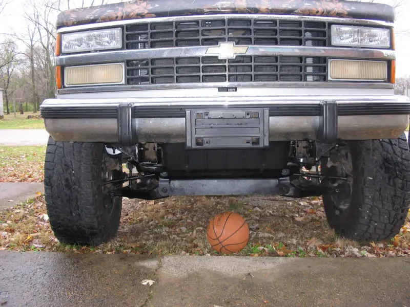

I see 14" of ground clearance with 35" tires. This is more than just a few inches gained, it is more than doubled.
The longer control arms and axles will increase the track width, and thus, increase wheel travel by at least 6" . I think a wheel off set could tuck the tires in a bit

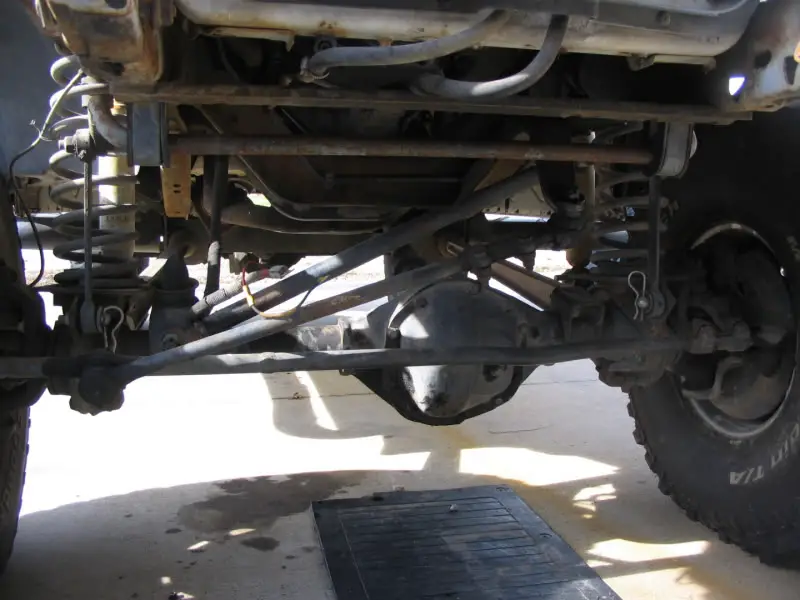

I am curious as to the front dana 44 pig clearance, on 35" tires. Looking at the one in my driveway--I think hmm, that is kinda low actually. Not to mention the steering link being the first thing sticking out there.
Think of a 12" imbedded rock that aint moving--and no way to get a tire on a higher spot to raise the differential out of harms way.
I don't want to seem like I am arguing, I just want to point out how significant the benefits could be.
