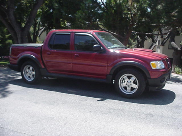

265/60/18s and dropped
285/50/18 and soon to be dropped ;)
