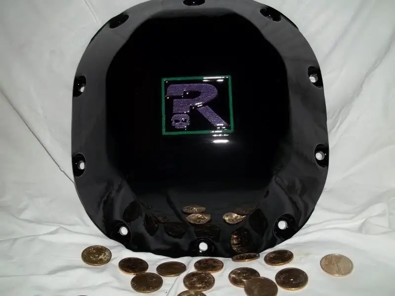

Yeah, about those Riddler covers.
If you get one, and wish it to look like this, let me know! :D
