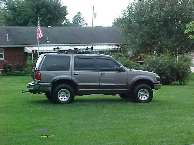

hey i just removed my door molding. it looks alot better without it let alone now there is one less place for gunk and dirt to hide when washing it. A IMPORTANT TIP: when removing the left over 3M double sided tape that is still stuck n in places dont pull the tape away at a 90 degree angle from the door as this will be hard to do and taker a looooong time to do. instead of scraping with fingers and finger nails just take the tape and GENTLY pull it away the opposite way you are removing the tape from at about a 45 degree angle the tape will come off in less than 1/8 the time it will take otherwise. it took me about an hour and a half to do my right side. and then after i found this little trick out it took me a half an hour to do my left side. so if you all want to save yourself from some blisters i highly suggest you do it this way.
