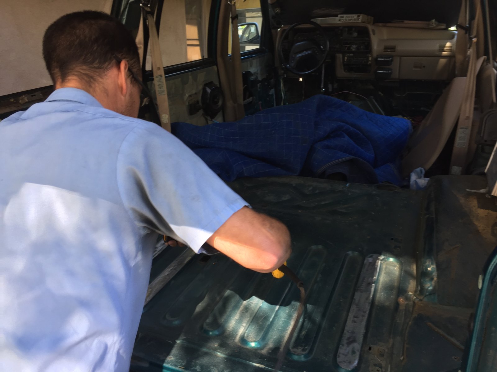

Does you interior look like this
Almost exactly, except I left the door panels intact and removed the seat belts. And, the body under the carpet / panels looks showroom new. Guess I don't need a picture anymore, thanks.
you going to put just regular bolts back in for the seat belts?
I am going to put the seat belts from the donor into my Explorer and use my bolts. They are rust free.

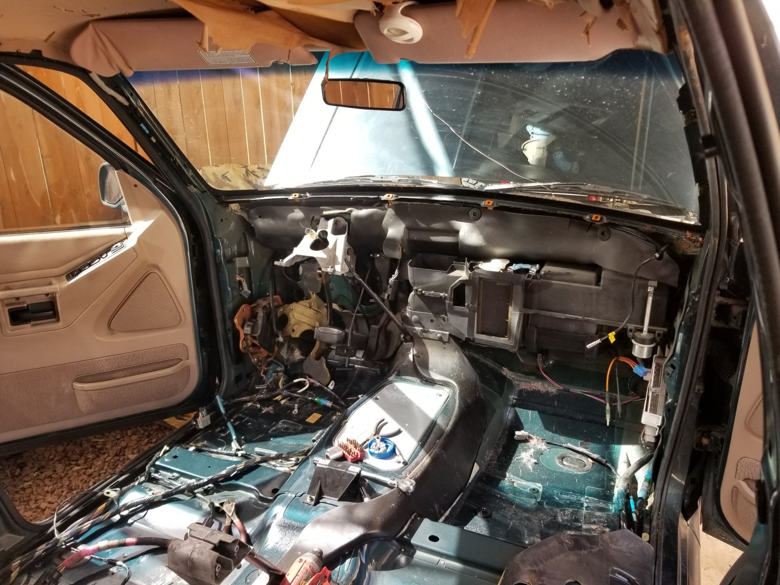

Today I sprayed the burnt area of the inside of the firewall with Purple Power. Then, I pulled all the body plugs and hosed out the interior. Its still blackened, but it cleaned up pretty good, and the best part was the smell is mostly gone. The wire channels down both sides of the body had a lot of dirt in them from all the years of off-roading. It felt weird hosing out the interior, but it was effective. Tomorrow I am planning on priming and painting.

Today, I got the inside of the firewall primed and painted. It sure looks better than it did yesterday.

Pic of the inside of the donor;
damn that body is clean! The firewall respray looks great
It does look good. The donor body is shot, but looks good from the inside. If you look at the bottom of the picture of the interior gut, you can see the rust coming through the body mount bolt holes and the rear floor seam. Its about dead. A few more years, and the interior would have looked like the undercarriage. I was going to pull the gas tank skid plate until I got a good look at it. Mine looks better, even with all the dents. One of the many things I checked for rust was the doors. With it so close coming through the rockers, I thought the doors might be rusting on the bottoms. They look better than mine, no dings or rust.

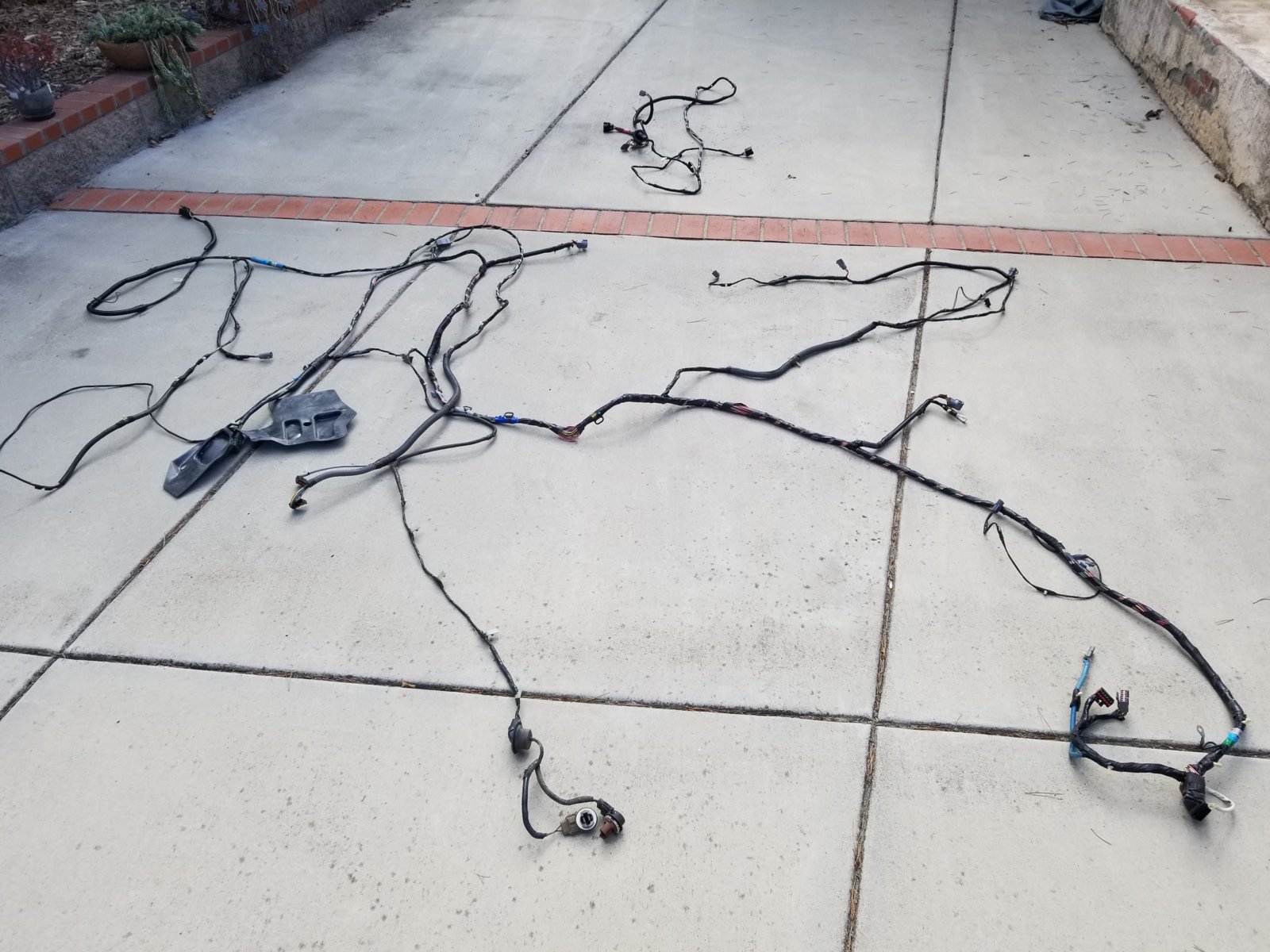

I got the donor dash and entire interior wiring harness out intact. That is a lot of wiring. The only areas I think I might have to do some splicing are for the dome and third brake light wiring because the cage is up tight against the head liner and I don't think I can get the wiring past it. Not critical components anyways. Found out the wiring harness for the electronic 4x4 is a separate harness, so don't need that. Also allows me to pull the controller box from the left rear quarter panel.
Interior wiring harness in all its glory;
The carnage;

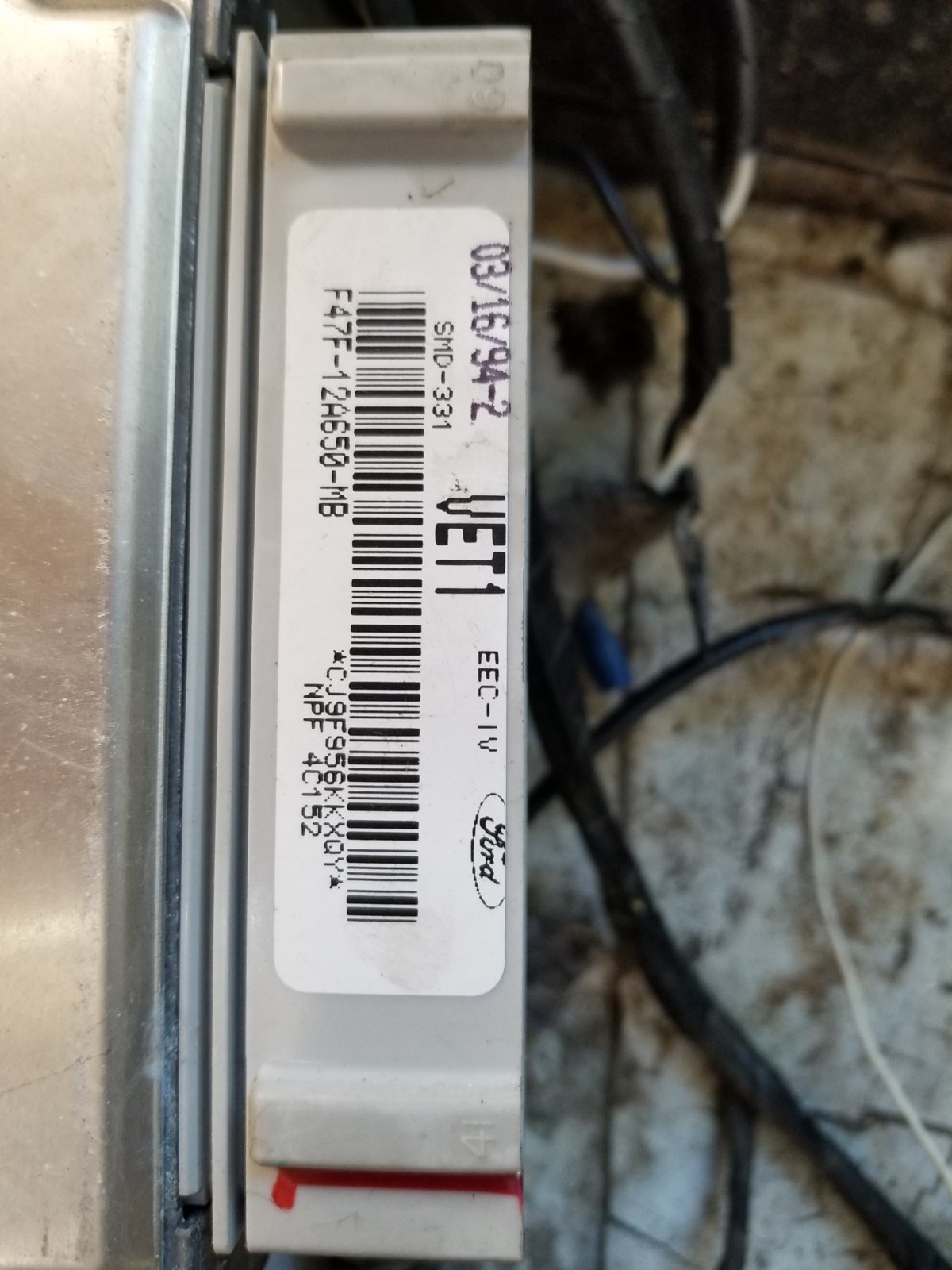

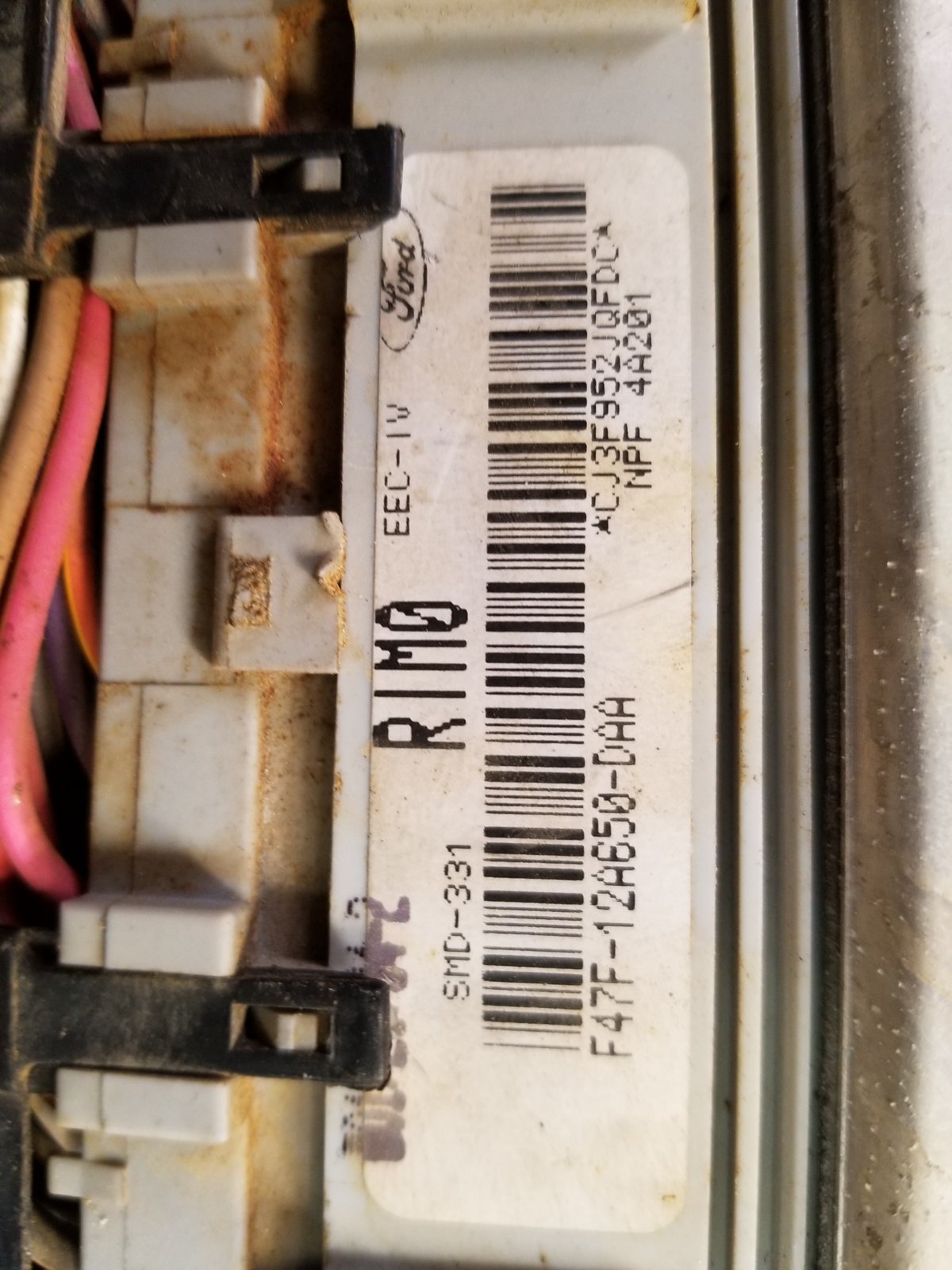

Pulled the EEC to keep it safe. Does anybody know if these two are interchangeable?
Mine (the dirty one that got wet);

Kris answered my question about the EEC's. He doesn't see any reason why they wouldn't be interchangeable. The VET-1 unit I pulled from the donor is the last, latest updated version. I am going with that one.
Good to know about the separate 4x4 wire harness. Would make replacing a manual t case with an electric shift one pretty simple. For what it's worth I tried using ecu's from a few different years and models when I did the auto to m5od swap with no difference; however, I'm not sure if that's always the case. I ended up using the original ecu from my truck because it worked fine with the transmission swap and it was newer.
