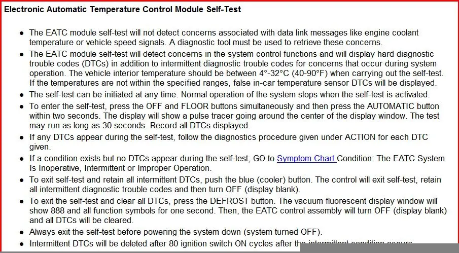

So, my 99 EB 5.0 recently started clicking when I would go from cool to warm temp setting. Then, the clicking stopped and was stuck in cold only coming from the floor vents. I figured that the blend door actuator had broken a gear and ordered up a Motorcraft replacement.
So, I removed the old actuator and went to install the new one. I decided to check it before bolting it in to place. When I plugged in the connector, the shaft does not move when changing the temp setting.
So, did I get a bum actuator? Or is there something wrong with the EATC that is not sending a signal to move the actuator?
