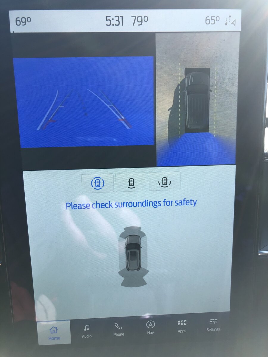

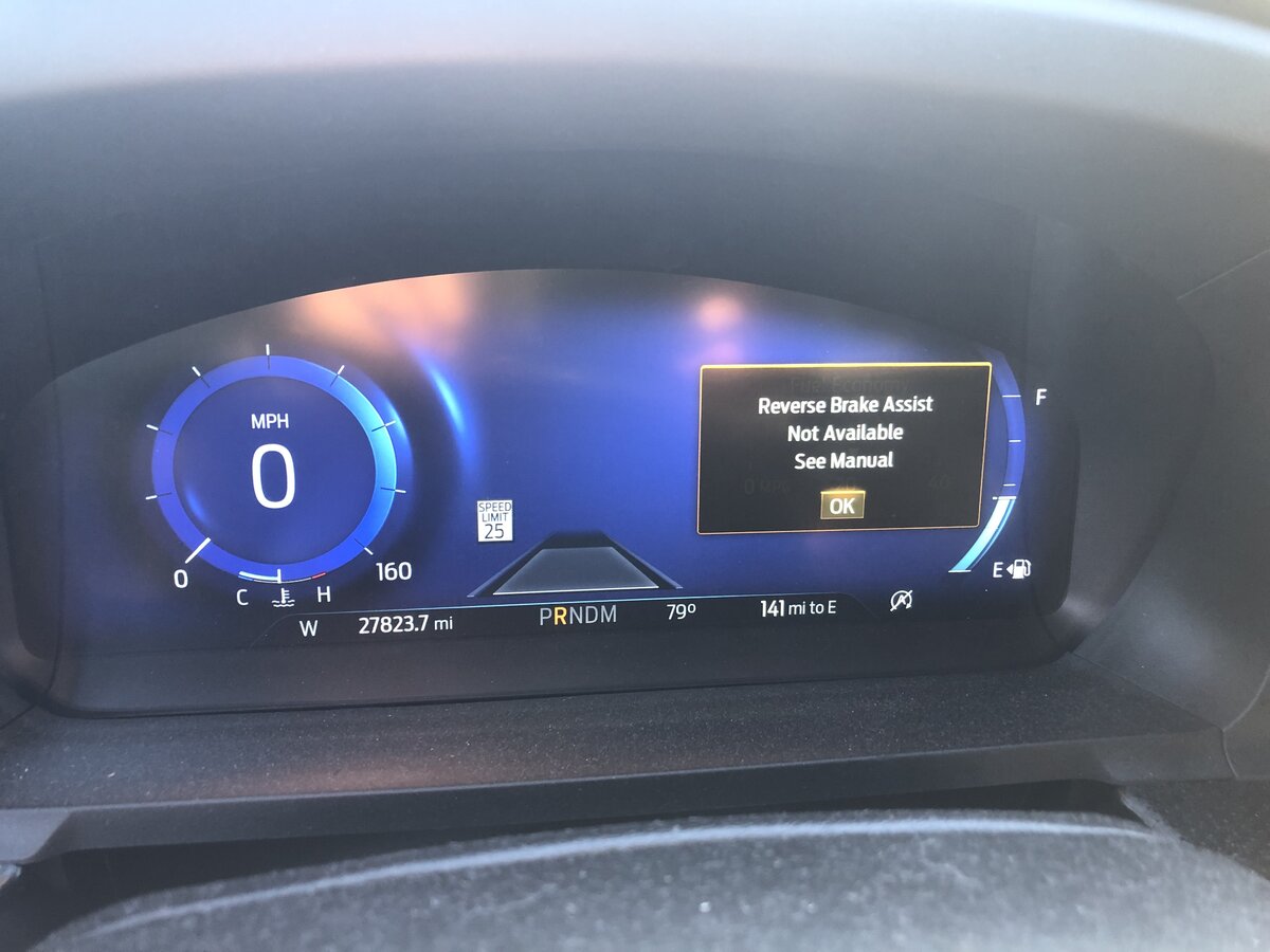

We had the blue reverse screen issue on our 2020 Explorer ST (pics below). This forum/post was very helpful in making me an informed consumer at the dealership. Thank you!

View attachment 429762 View attachment 429763
