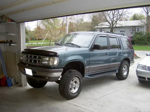

SOA is about sone, few tweeks needed:
looks great look atmine the oter way fronts done and without the rear done...
looks awesone and i think you will clear 35.s i sure will

This is a big mistake but hey its not my truck. Have fun!
Chris, looks good. I like those cobra R's on it. Now try and go do all those burn-outs that you are famous for. ;) Can't wait to see it done.
-Drew
When I get my spindles, and use all the TT I might have to shackle or AAL the rear to make sit level.
whoa you should leave it all cracked out lookin like that
put like 33"s in the back and keep the lil tires upfront all with the white cobra
maybe not because on mine i have tt all the way up right now. and the rear is the long shackles and 2 add a leafs on each side and the back still sits lower.. makes me wonder if i should have done SOA,
boomin how difficult was it for you to do the SOA. how long and what was the toughest part of it ...
I have the spring perches I bought off of someone here already.
could i taje them to a place now and get them welded on just exactly like they are on the axle now just the top. and keep the angle the same...
what about the drive shaft any [roblem there but then again yours is shorter right cause i believe you still have a transfer case??
on the first picture from looking at the front wheel on the inside the spindle is too close to the loer control arm.. I should have taken the grinder to it a little bit. as my turning radius is not what it was can not take a sharp a turn now..
you can see the 2 new leafs in each pack.. i might be willing to take these out or maybe just one and lower or remove the shackles and the SOA might be perfect..
i think if i keep the tt the height it is now I might have to do something to the back I will need to keep the front as it is to fit the 35's if in fact i go with them..

boomn do you have a close up of you new set up??? curious to see the close up of stuff like spring perches and how they look welded..
nothing is welded yet. Im still trying to set the pinion angle perfect to my spec's. I'm not likeing my current SOA setup. Im going to change it tomorrow with square u-bolts, change the placeing of the shock and reroute the brake lines. I'll get better pics then.
