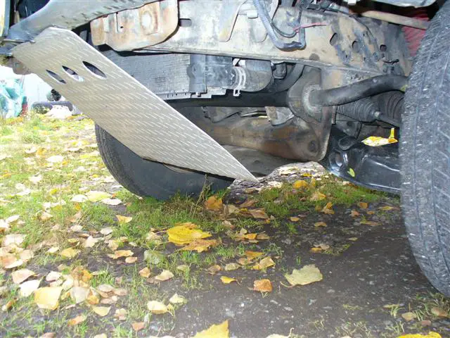

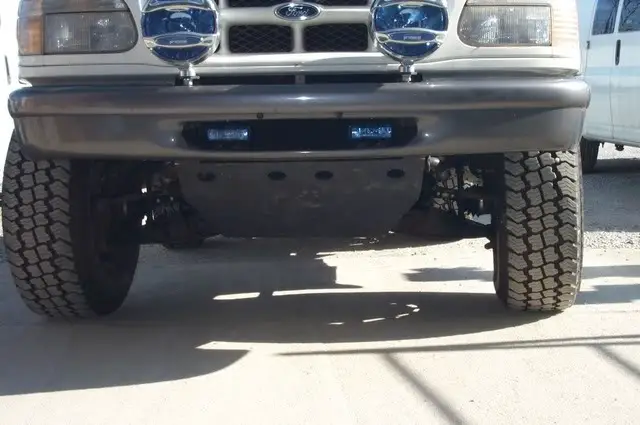

updating a bit my 3 yr old post :D
I fixed the bends so that the skidplate no longer hangs down below the x-member.
I also drilled 3 holes, using a hole-saw on my drill, to allow more air to the oil/transmission coolers and a bit more to the radiator.
I did all this way back when, but figured I should update my thread :thumbsup:

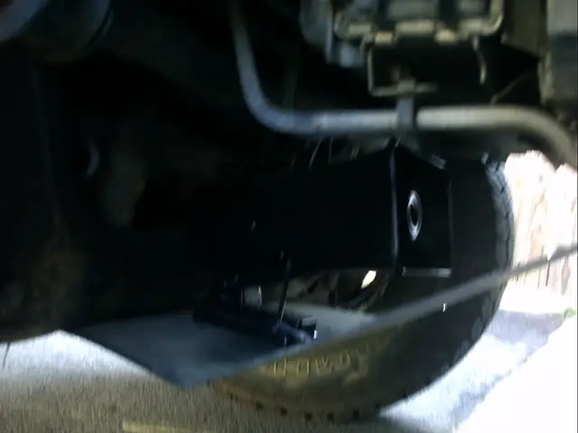

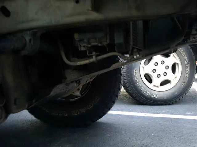

mine was just like that. one thing i would suggest, if you wheel alot, is to add bracing to the frame rails
here is why
before my obx beach trip
after my trip

how are these bolting to the crossmember? my bolts are kinda sunken in and I'm not sure what else they bold to. any help would be awesome!
well... I had parts left over from my body lift.
namely, a ground-wire drop bracket or something?
can't remember what it was for, but I didn't need it.
it's basically a ~3" long bar with a stud at one end. I placed that into the x-member, and then drilled a hole in the skidplate, and put on the nut and lock-washer.

no, I didn't need to do any drilling in the x-member, because there are already holes in it.
