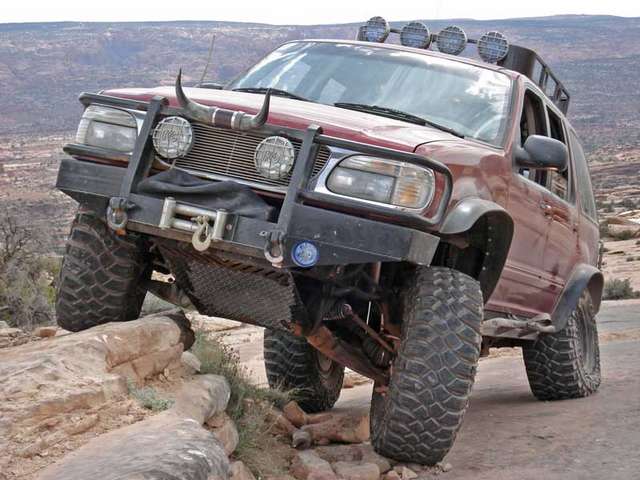

That is a nice truck!
CG's truck is stock except for a BL, better shocks, and tires right? I guess it just goes to show haw capable explorers are.
