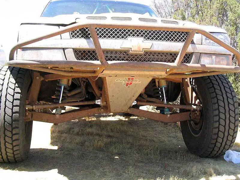

Thats a little difficult to do because the engine is in the way (for the upper arms). And if only the lower arms are moved in, then the vehicle will have very bad camber angles during suspension cycle.i think a center mount a arm setup
I guess I'm confused.in order to get center mount a arms to work with a front-engine vehicle, you have to incorporate an engine cage. it would definitely not be a bolt in setup.....
