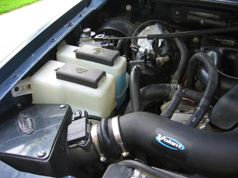

I wonder if the C&L MAF will fit on a Volant #19640 intake kit?
I've got Volant (as you know) and C&L (as you might not know). The filter box does a great job supporting the weight of the setup.
