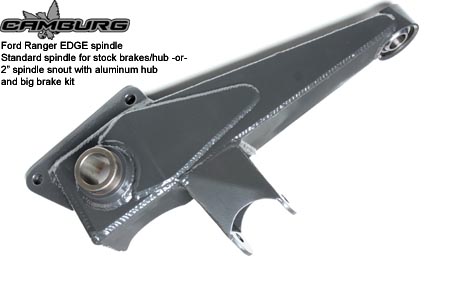

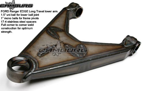

Well heres some pictures of just the Lower Arm, Spindle, and Steering.
I should be getting my kit maybe at the end of next week.

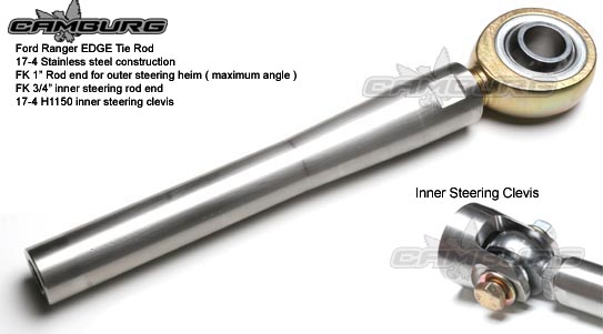

Hey so what do you guys think about some heimed steering?? Camburg now has it as an option...only $400 and it's essentially bolt on?? and i was wrong i joined the bump can club....i got two ordered up...should be sweet....hey biter, i mean dave j/k man, any progress with you
the steering is very good and makes a big diff. i helped install it on my buddy's ranger and its really not that difficult you just have to align it afterward because your toe will probably be off. i was thinking about the steering but im gonna wait till i blow one of my stock ones to get that upgrade. as for my truck its going into richer racing all next week and should be finished that friday. im dying to get it done because desert season is coming up!
