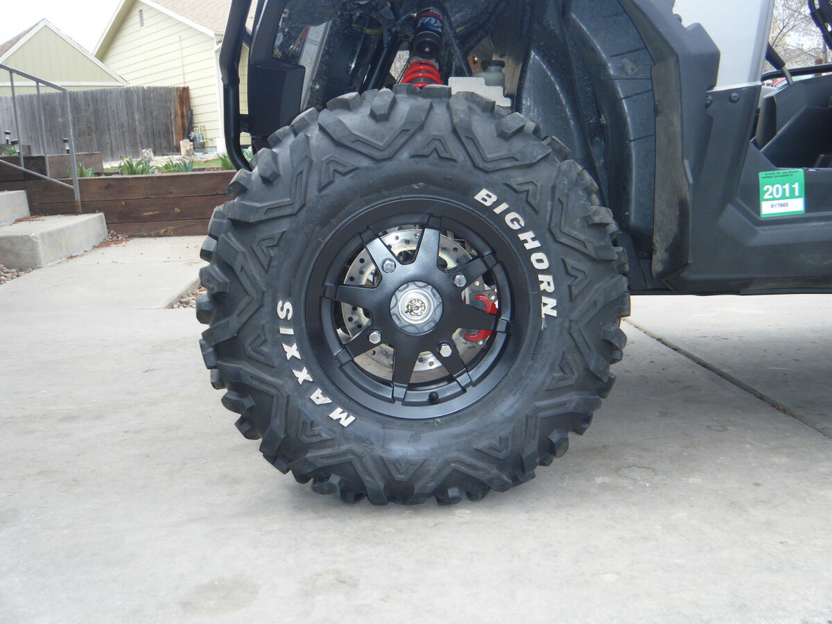

duplicolor coating for wheels, its textured and is designed for what you are wanting to do here... I have been using this stuff alot
clean wheel, sand with 350, wipe with acetone, tack rag and spray... it comes out really nice!!! I am doign the wheels on the wifes FJ this week and then the wheels on my BII... all with this stuff I am impressed!!! not as thick as herc, very touch and a nice finish
