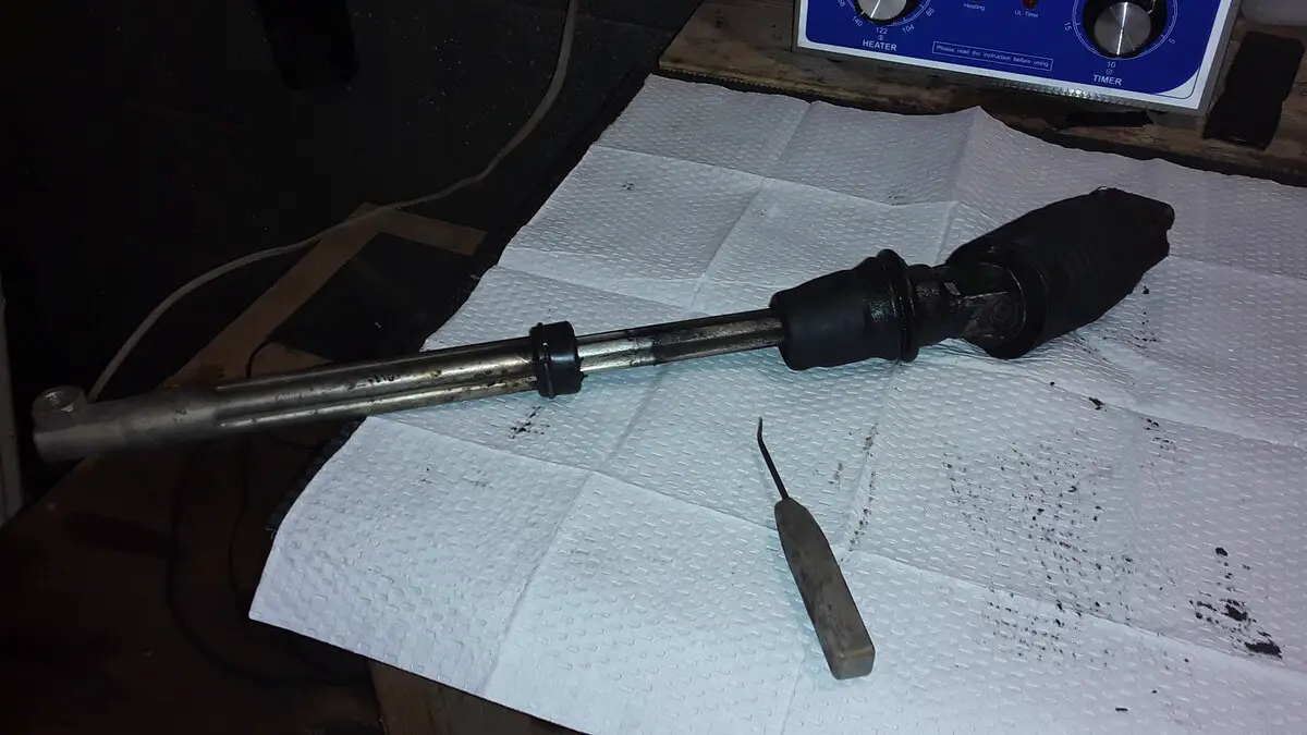

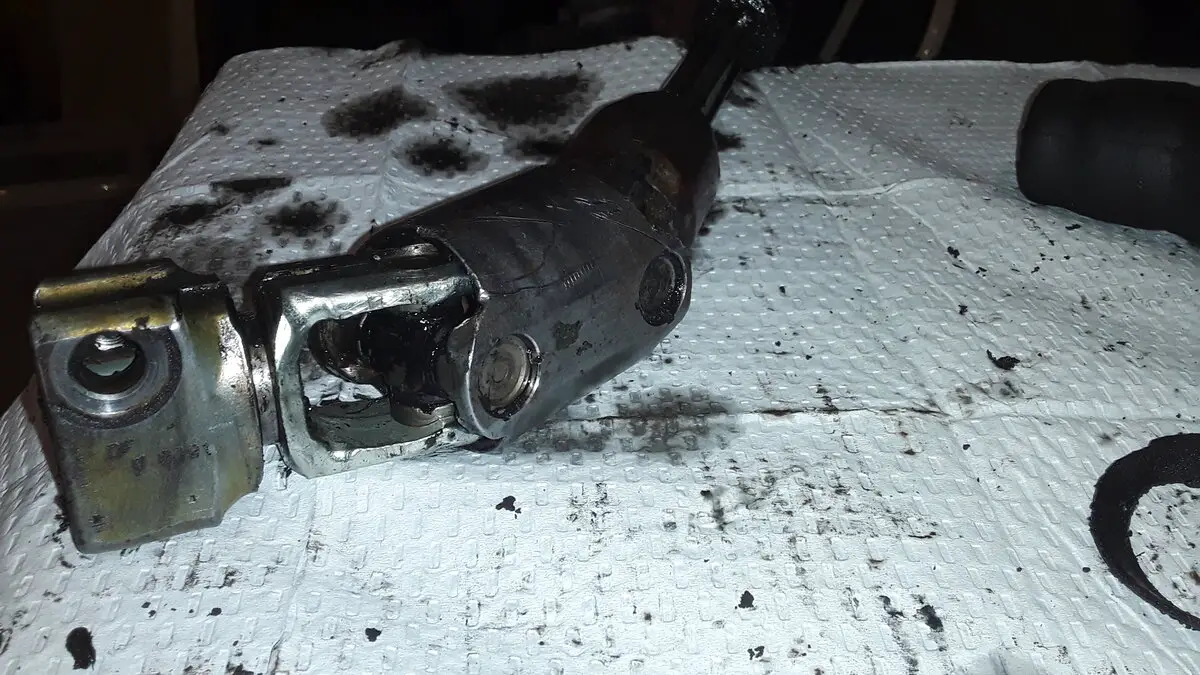

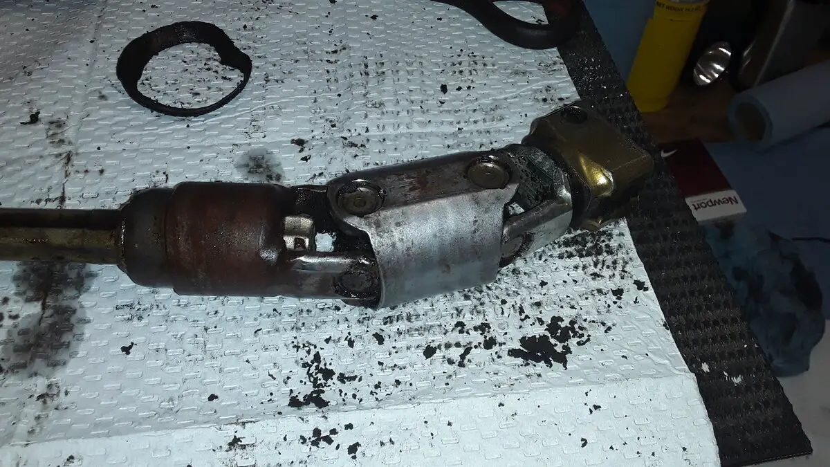

Ok I got lucky
Or I'm just ocd about my maintenance
Looks good imo
View attachment 323654View attachment 323655View attachment 323656
Ok I got lucky
Looks good imo

I’m convinced the boot was to keep things out of the shaft, namely brake and power steering fluid. not to protect the lube on the u joint because the stupid boot rips open by 50k miles and the shafts don’t get loose until 260k miles! Lol
