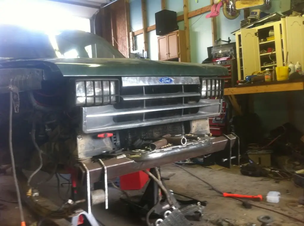

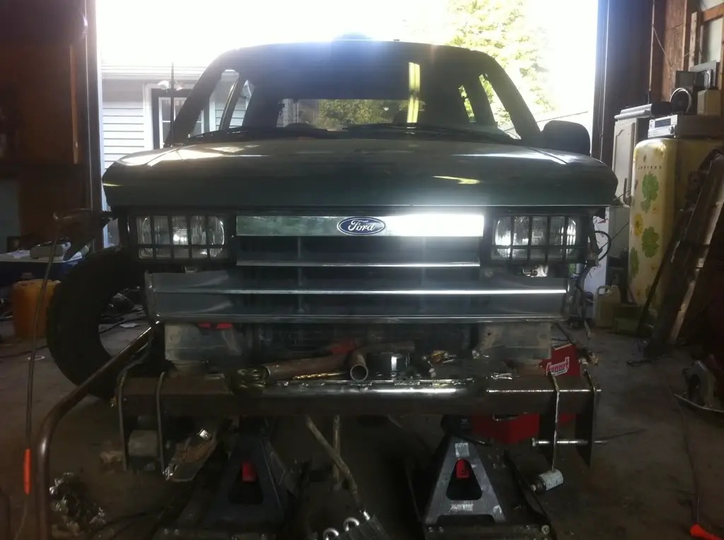

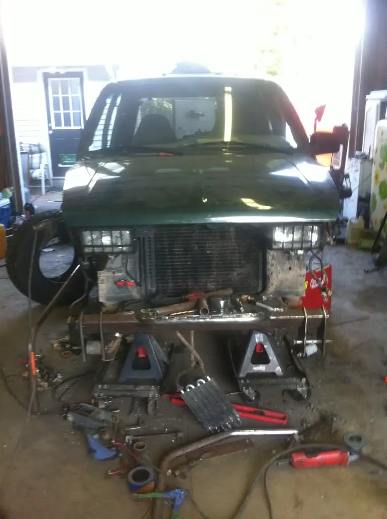

i picked up some original 89 toyota lights that came factory on the roll bar...for free.
figured id see if i could make them work.
dont pay attention to the grill, just hacked it up to get a look at it. ill be swapping over to a ranger grill as ive never been a fan of the expo grill.

i like your idea for the headlights. the only suggestion i would have is getting long range driving lights instead of fog lights. or using both:D
It won't be drove much on the road at night, hell I'm usually in bed by 8:30 lol
But there probably will be some other lights up front eventually, those were mainly to keep me legal and they sort of look oem so they should keep me out of trouble though around here they don't care much.
