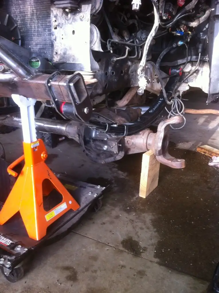

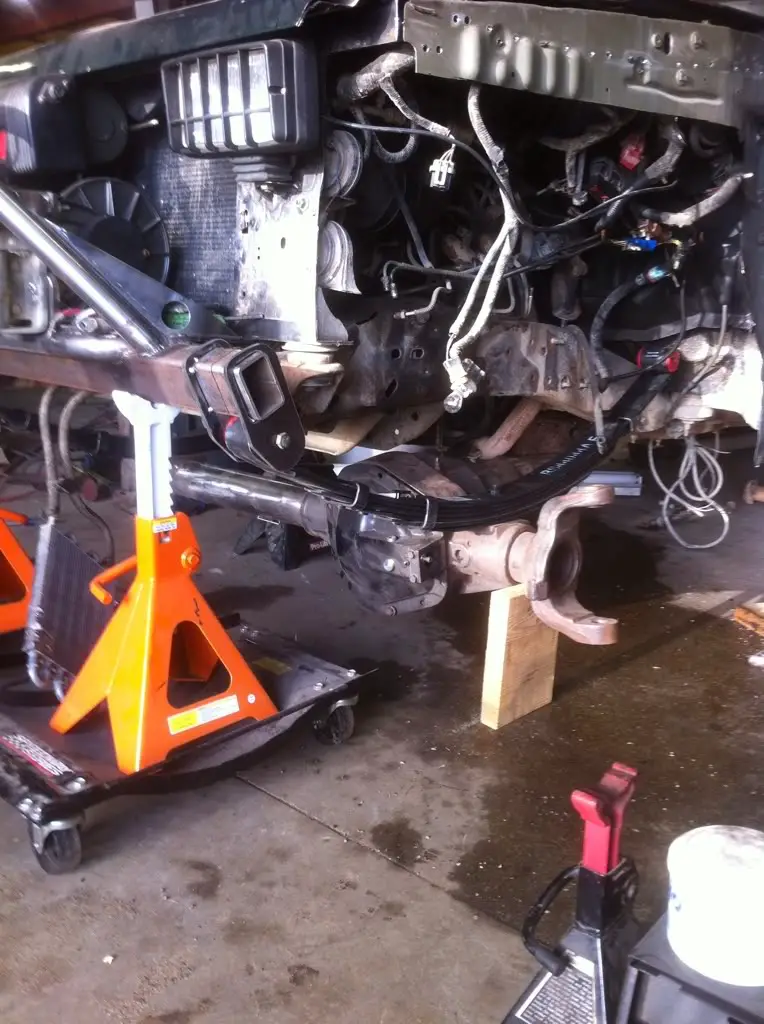

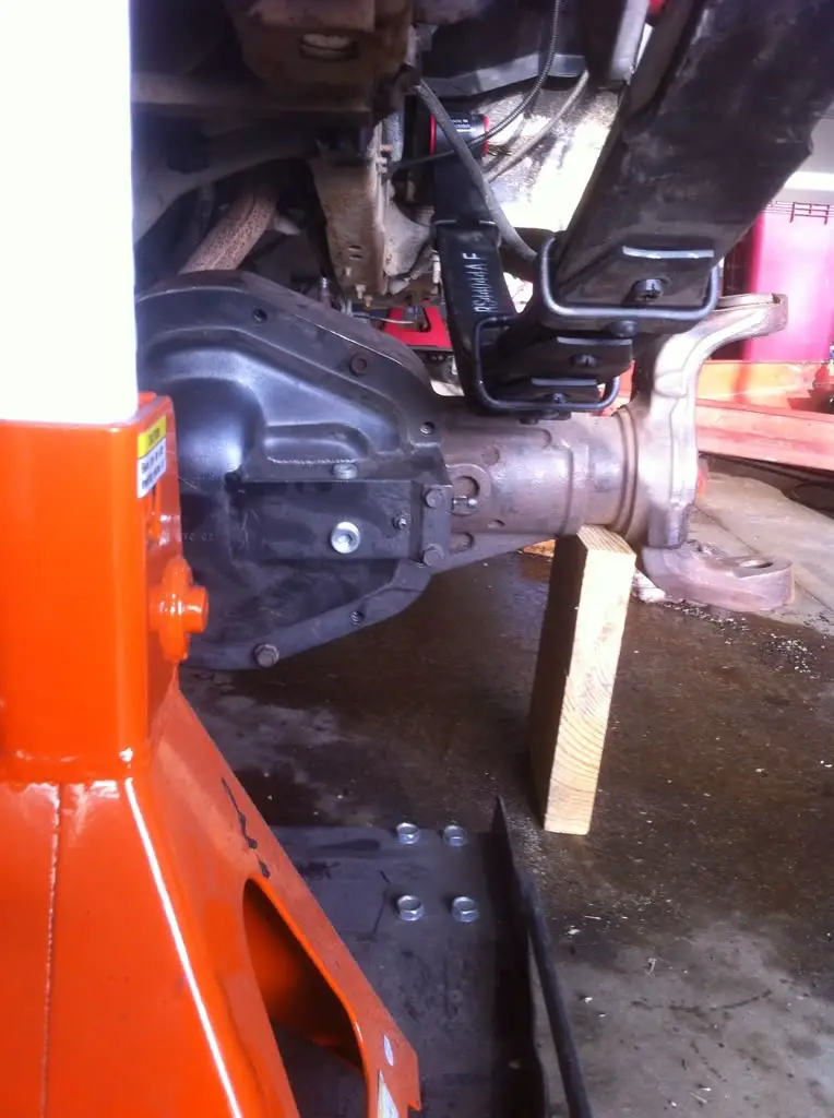

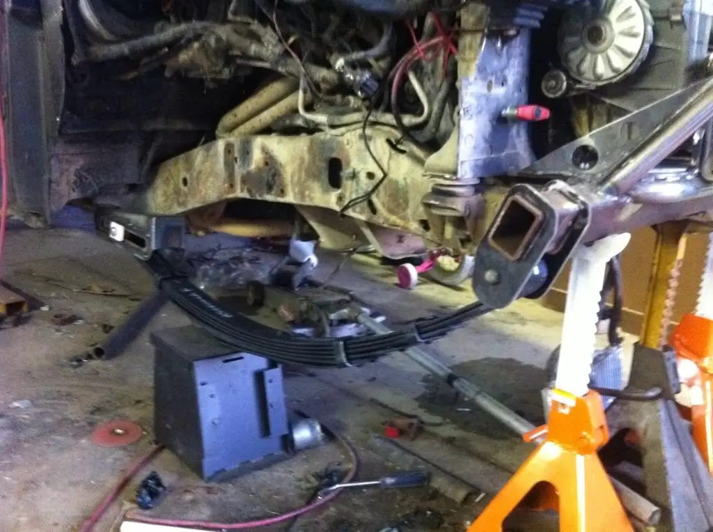

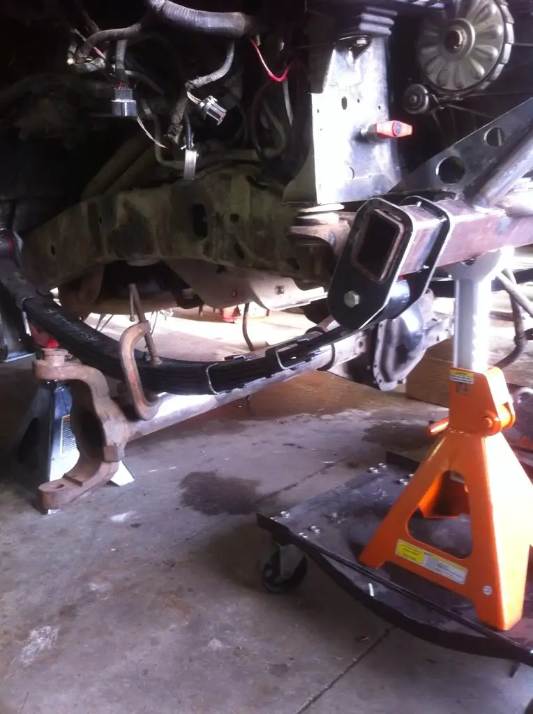

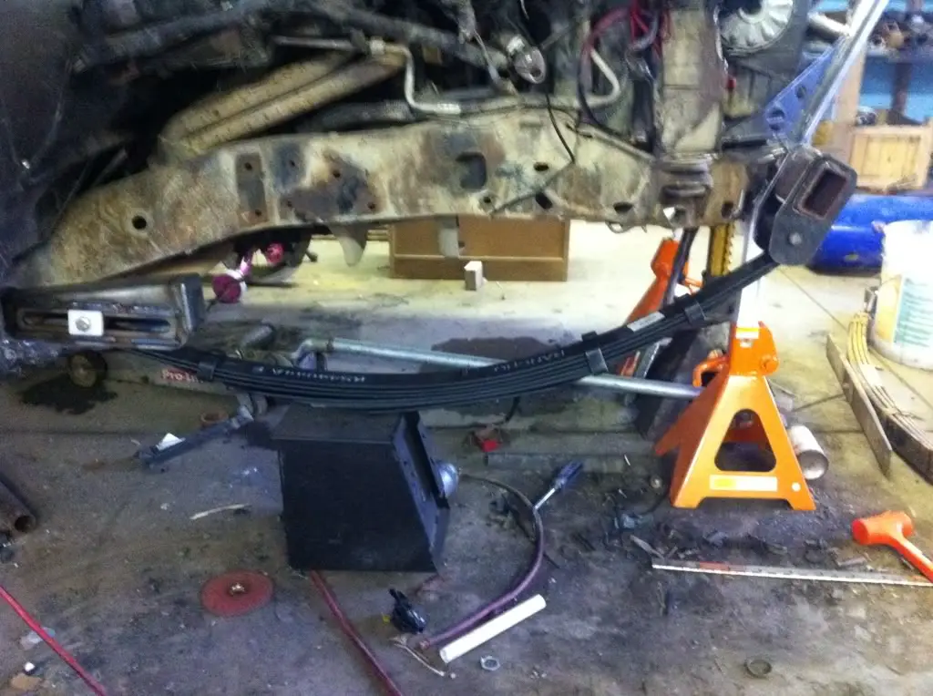

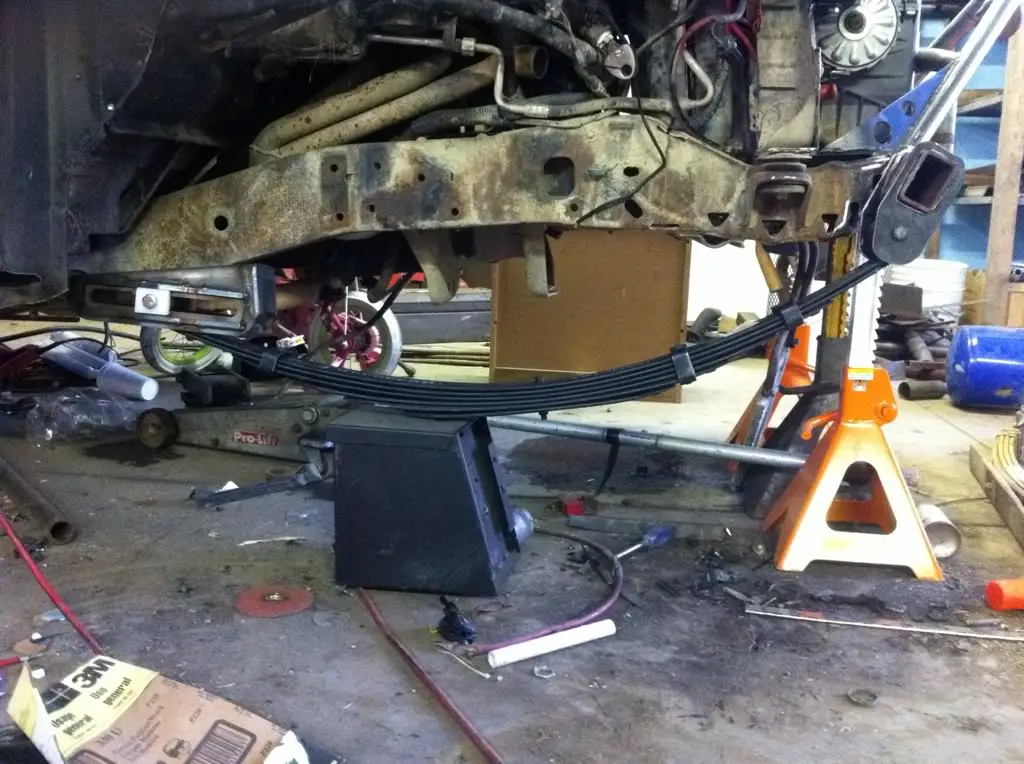

The front leaf springs are ordered and should be here soon along with some other goodies that I'm going to give a try and see how they work. I ended up going with the rancho 44044 leaves and spring sliders from liquid iron industries.
I have never seen a "shackle" like that. Won't that change your caster more than standard shackle?
Tell me more about them, please. I've been trying to figure out how to do a 4" SOA with 63" Chevy springs. that may do it. did you make that or is a pre-fab thing?
Edit: I Just noticed you mentioned them on the previous post. I'll dig around for info.
The are from liquid iron industries, they rent cheap but high quality pieces.
They low you to have lot of travel without the use on super long shckle's which also make you have to set the rig very high. Also reported to be a lot more stable then a standard shackle.
My plan is to also run them in the rear frenched into the frame along with the front spring mount so I can fit the 63" chevy's and still keep it low.
Things are going to be tight, the SD 60 is going to make it a pain in the ass. But I'll figure it out.
Wheelbase is going to a lot longer then I expected, looks like at a minimum 123"-125".
