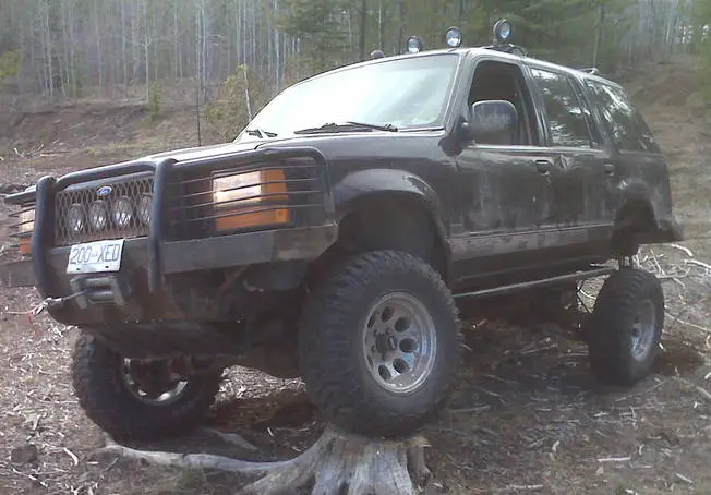

I want to i just wanna make sure its what i really want before i get to carried away ive built soild bumpers and rock slider as a starting point
Cool, just be sure you have a plan for every part of it before you start.. i thought about it for quite a while before starting to build.. knew where i wanted the tubes etc.. (of course new ideas came to mind during the build haha)
also consider you will need cross bracing.. i have some diagonals going to the frame rails.. they go through the cab (one behind the front seat, and another at the back)
and of course.. try to keep it as light as possible.. .120 wall on the outer parts of the cage, and thin wall tubing for parts of the cage which are just push-pull tubes.
