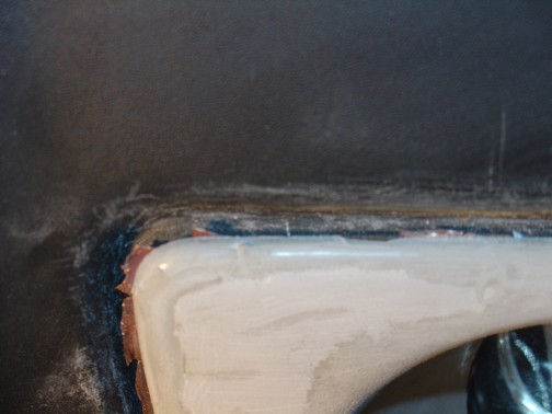

I still haven't figured out how to remove the darn chrome things and my patience is wearing thin, so I decided to remove the chrome, finish sand, prime, and paint while still installed on the truck.
It works well to put the truck up on ramps and sit in a chair while doing the work.
I used the propane torch trick to remove the chrome. It worked well, In some spots, too well and distorted/melted the plastic requiring some body filler and a lot more sanding. But alas, it s starting to look good again. I have only done the drivers side so far. Wonder how one chrome and one flat black will look?
The chrome is extremely difficult to remove from the edges. I am still not sure how I am going to finish that task. Any ideas?
Here is a pic of the partially finished part.
Note the edges; thats where I need to get the chrome off.
Please forgive the poor quality photo.
