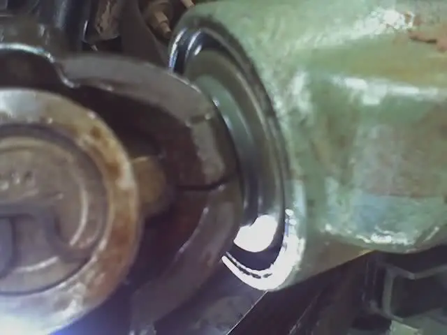

I was out this past weekend and broke a u-joint
messed up the end of my warn axle.
looking to go with the yukon axles and super joints
any ideas???
