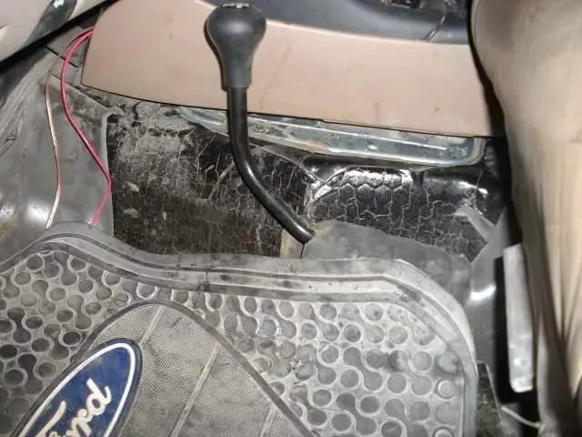

Just thought I'd throw up some info incase anyone needs it.
The front 5.4 shaft will work mine is from an 04 F150 and is the correct length.
The shift linkage that seems to be really hard to track down, doesn't have to be, the linkage and shifter from a the BW1356 case will work as well with the only necessary modification that needs to be performed is to drill a new hole in the linkage shortening it up. Mine came from a 96F150.
