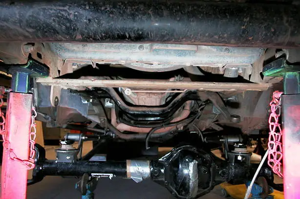

Steering box is on. Looks like there is going to be some tight tolerances for one of the hoses for the hydro-assist, so I may have to take it to a hose shop and have them put a 90deg fitting on it.
I may also end up trimming the stock engine crossmember back and welding in some support plates of my own.
Getting closer!
It's not the easiest thing to see, but my crossmember was cut and reinforced with tubing.
Some 1.5" tubing that I have (hell, it's what everything is made of :D) would work nicely in there. I was thinking about using the tubing as well.
I should know better once the axle is in and where everything is gonna be.
Thats gives me a good visual of how to go that route too. Thanks Rick.
