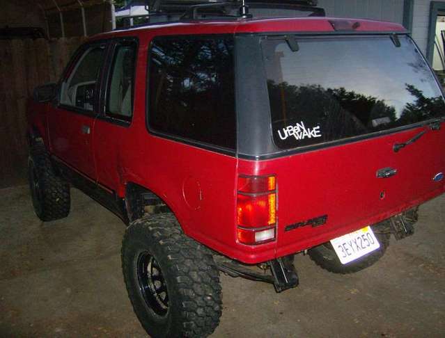

Nice work remembering to mark which cap is which. That's funny that both of your explorers are red too.
