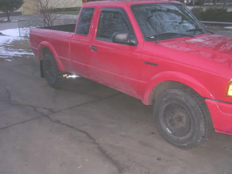

I had mine replaced with 2.5 pipe that exits from the side right behind the rear tire. it's tucked up nicely and doesn't drone at all (i have a sport too). no resonator or anything, with a flowmaster 50. kinda wished it was a little louder even. the exhaust guy had discussed having it dump out in front of the tire, but i figured it made more sense just to have it behind. but sounds like either is possible and wouldn't be a problem. it looks a LOT better with it tucked up, mine looked like crap after the body lift too. i'm pretty happy with it overall.
I have it on my 5.0 Mountaineer. I still have all 4 cats just got rid of the muffler. It hangs down low but no lower than the front spring mounts. Like Turdle said I would be worried about crushing it when I hit some thing.
