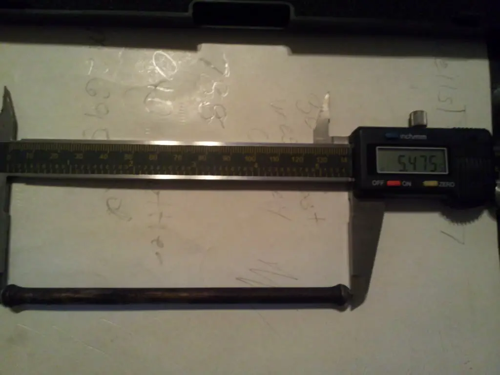

Everything is stock? Heads havent been touched?stock lifters? Yea you can measure what you have or the pushrods delta gave you,all that should be very close.mine are 5.475.you can go to rockauto and they should say the size of stock,think they sell three sizes that are all very close in size,think they do that for different head gaskets or lifter desine
Just measured mine again and yep 5.475
Stock
And the measure tool,you can see it has plenty left to screw in and out
