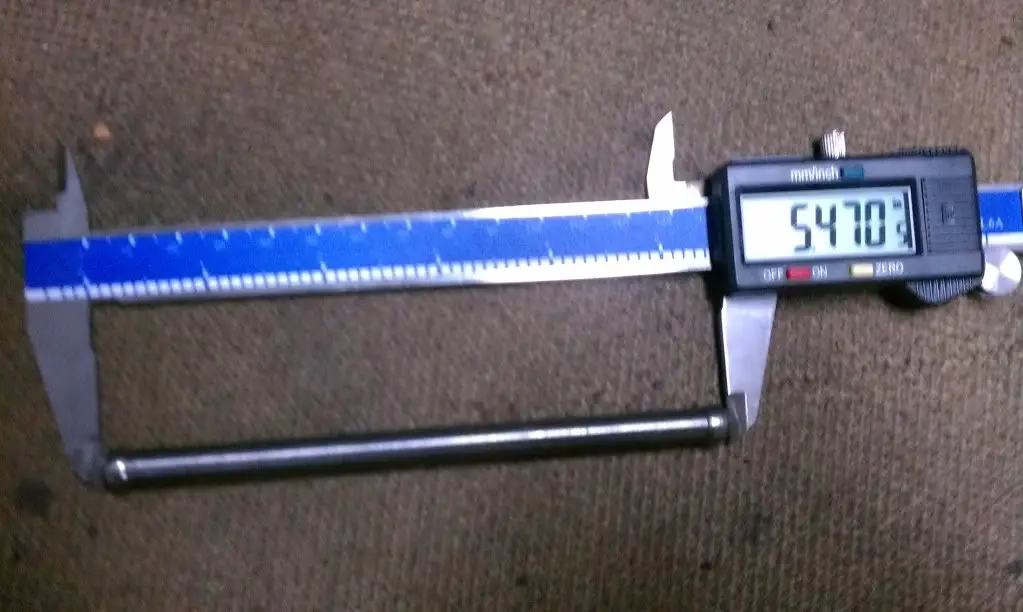

Delta cam ones sent to me with the rockers, been in there for the past 1500 miles. Its funny i thught stock was 5.475, can it be that deltacam is just low quality?
Thats very very very close.like i said they made three different size rods,i dont know why but assume its they changed head gasket material or lifter spec i really dont know that.thats within spec tho.
I was going to say, .005 is not a hell of a lot. Wonder what they were prior to installation. Maybe I will run what I receive from Delta and measure it all up before installation. If they start making noise I can pull them and measure again. I can also measure the heads and make sure they are in spec prior to installation too. We could do a thread on the final word on Delta rocker assemblies...

Man i need to learn how to quote... Ok so this is my 98 explorer, i believe that would make tgem 98tm? I measured every pushrod for an average of 5.470. And i thought with delta rockers they sent you small than stock anyways to make up for the cup but .005 isnr much diffrrence, wouldnt that make mine too long if 5.475 is stock rockers?
