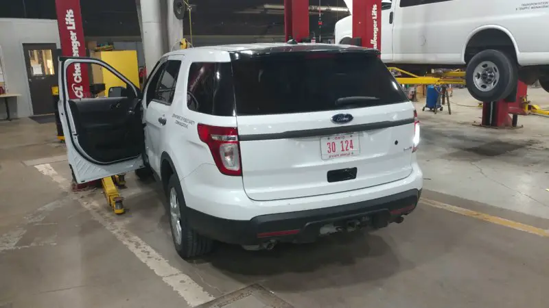

Okay, now what about 4/7 pin harnesses? I've seen dozens of numbers bounced around, with prices from $50 to $250.
This is going in a PIU. I have backup sensors and Keyless Entry. No Blind Spot sensors or anything else.
People ask me why I'm doing this. Simple. We have a PIU at work with the tow package installed. So I know it can be done. This vehicle only has the 4 pin harness however.

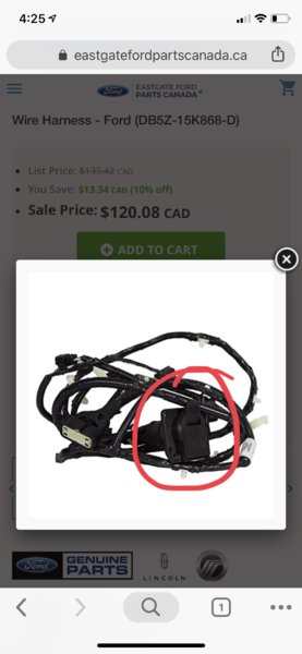

Sorry to resurrect an older thread. I finally got around to ordering my upgrade and the wiring harness came in without the final connector.
Has anyone else had the same issue?
