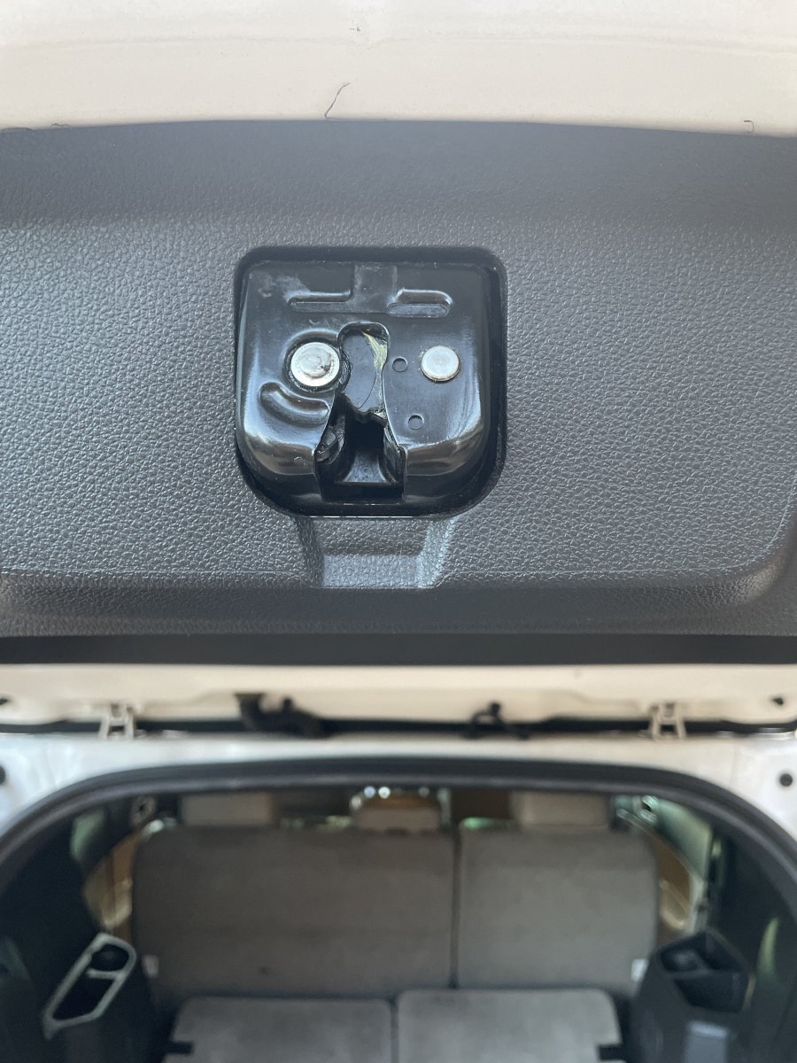

4. Take a flat head screwdriver or some other rod and on the latch to the tailgate push it up to the closed position
( Closed position )
5. Manually shut the tailgate ( it will not latch because its now in the locked position ) this will trick the sensor into thinking it’s closed
6. Manually open your tailgate and your dome lights should be off

1. Press the tailgate button on your dash this will unlock the latch but the tailgate will remain open
2. The latch should now be in the open position
(Open position)
3. Manually shut the tailgate
4. Get back in your explorer and start it and watch for warning lights indicating that a door is open ( if it is then step back out and give the tailgate a shove to ensure its latched )
