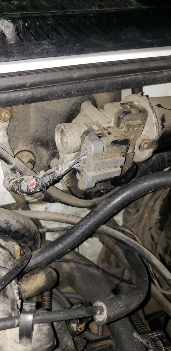

Is this the main set of wire that everyone is talking about going from the PCM to the sensors?

No those are your wipers. The harness would be more toward the passenger side. When you take off valve covers, that crappy mechanic could have damaged it. It runs very close to the passenger valve cover.
Ok thanks, it's deep down inside by the passenger valve cover? Not sure if I can find it but I will try. What color is the wire?

I need to find a map of the 96 engine bay.
