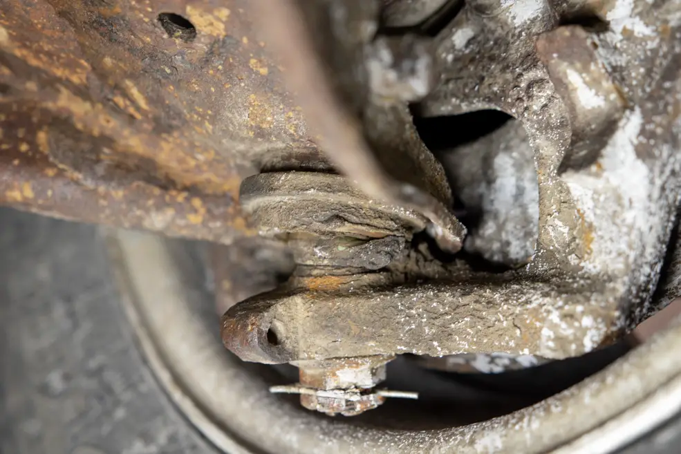

Those upper control arms look original. Looks like the lower BJs have been replaced at some point, but they look rough. Uppers look real rough. Those outer tie rod ends look new-ish and well greased?
My #1 priority here would be ball joints...which means lower ball joints and upper controls arms with ball joints.

Ball joints are very common fail points and will cause tire wear. I guess pro installation cost a bit but it is a relatively easy repair. Anything is going to have wear and tear at this age. I never heard of them failing catastrophically though. The way they are loaded it is unlikely. What you could do for now is get a cheap grease gun with a pin and shoot grease in the boots. It is a stop gap so you don't have metal on metal. If they don't have crazy play do at every oil change. Not perfect but it will reduce wear. You could get boots for them too, I replaced my lowers but my uppers had torn boots and are still tight, I bought poly boots and I fill them with grease.

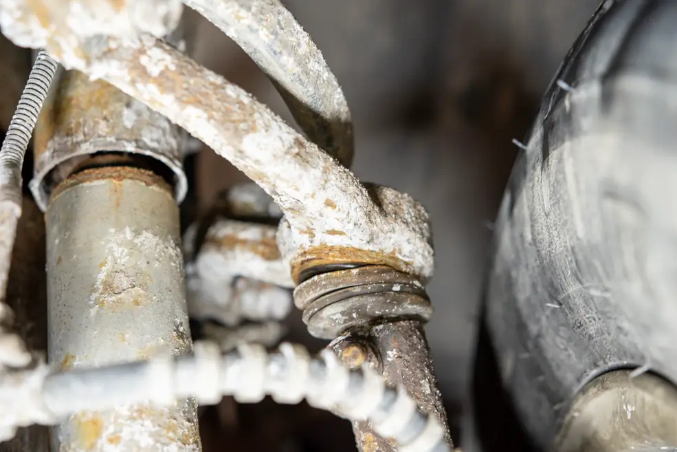

Your lowers are greaseable. Uppers...I can’t see well enough to say definitively, but likely not.
The only issue with the 12/6 test is that a badly worn hub or blown out control arm bushings can also cause play. It’s a good test for determining play exists, but additional detective work is often required to figure out exactly where.
I’ve seen BJ failures, but they are rare and often give PLENTY of warning...I'm talking groaning and clunking ball joints for months and months...but when they do, it’s ****ing ugly.

Not greaseable but just for now to shoot some grease in the boot, so there isn't metal to metal. Metal to metal causes extreme heat and failure. Nothing is going to fix them at this point. Mine had no play (I tested apart), but also lack the resistance of a good joint, so they were a good candidate to refurbish. The lower BJ are actually the same part as the F150 from that era.
When you put grease in your uppers, did they look as bad as mine do now?
Yes, the boots were gone, but they had no play when I moved the socket. If they have play, metal is missing, eventually the ball can pop out. I don't know what shape yours are in. Of course I know how to monitor them every oil change.
Cheap ball joints are not an option on this truck. Moog has a good redesigned ball joint. Probably ACdelco (professional line, not their value line) is good too. They probably rebox some premium brand. I doubt GM is making these for old Fords (Although this part was used up to the 11 Ranger). The rangers kept the same front suspension as the 95-01 explorers to the last truck. Once it has quality parts it is pretty heavy duty. I use mine offroad and it holds up fine. And the UCA is still OEM.

No, the factory ones are lubed for life. Not made to be serviced. The grease is put in what is left of the boot, it is a stopgap. Service ones have zerks for a grease gun.
Bottom ones are pretty bad from what I see. 100% must be replaced. Top ??? probably needs to go too.

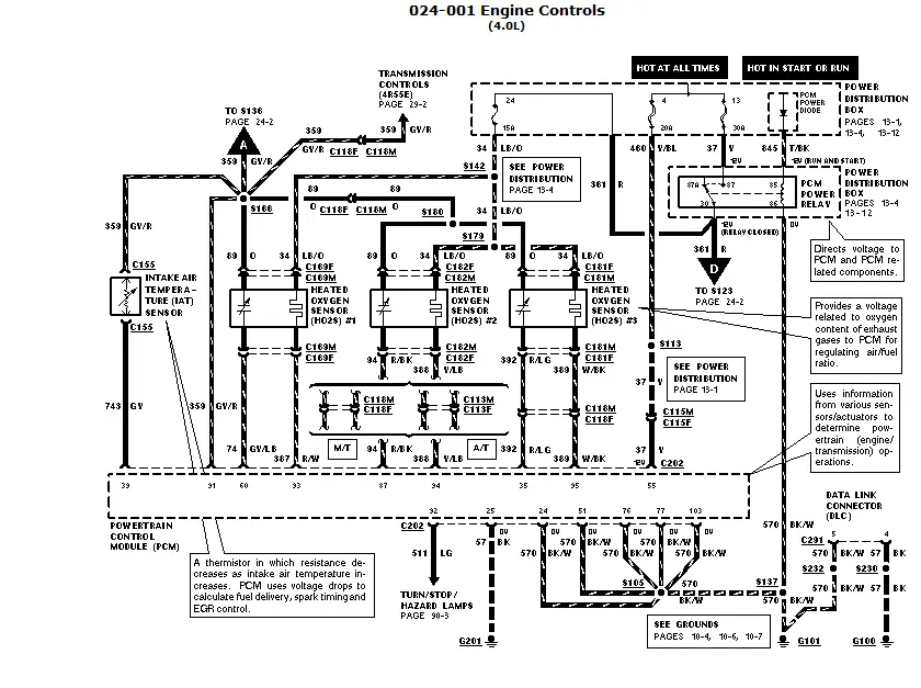

CEL got cleared but just came back on. Mech checked the wiring to the front two o2 sensors and said it's all fine. He also said it's not fuses. He put a new o2 for the rear and it didn't work. I will pull for new codes on it.
If I cant get this CEL cleared then why would I bother with the ball joint repair? At this point I really need to consider just getting rid of this even though I will miss it bad and all the lost time in the past month getting all this work done. I mean is it worth going this far and doing all this work on the truck and then tossing it all out the window? The truck runs perfect and better than ever right now.
I'm really fed up with the CEL. It has to be my non working temp gauge inside the truck causing it(fluctuates, always goes from warm to cold and constant moving), even though I just put in a new thermostat and new thermo sensor. Maybe I just keep driving it with the CEL on. I mean I'm so sick of it. It's not working, it's not the o2 sensors (got readings from them) and it's not fuses. And the chances of the heater circuits on both fronts being defective out of the box is like less than 1%. Especially NGK brand sensors.
No the BJs are more important. But the 02 sensor, zero chance they are defective. All three heaters share the same wire. Wiring could be marginal. meaning it looks good but can't pass the full current.
The heated sensor is not complicated. Just a fuse and the PCM involved. This is not much different than you would find on brand new car today.
Thanks. I need to figure this out. So now that my mech has crossed out any of the o2 sensors being defective and working and receiving voltage from the PCM just fine. And all the wiring under the truck where the sensors plug into are fine. And the fuses are fine.
I sure hope the PCM doesn't have to be replaced.
It has to either be the wiring under the hood from the PCM (near the firewall) or my thermo sensor issue (with it not working properly and going up and down between 1/4 warm to 1/2 warm and back and fourth.
Are you saying it's okay to drive the truck with the CEL on for the time being? What if I can't ever figure this out?
