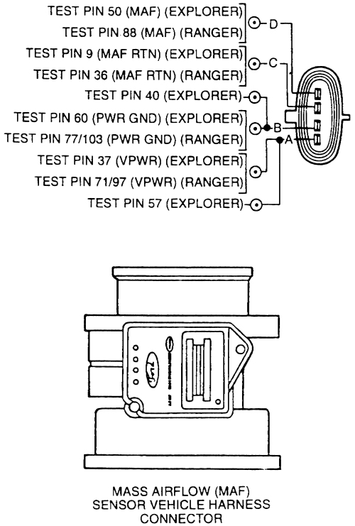

i tried, the one on #4 is -.06 volts, the one on #5 is .85 ish volts, so i'm guessing use the #5 wire
do you think you can go look at yours and tell me if our wires are the same, and if so which on you used, on the diagram above i cant tell if their saying the maf is #2 or #5? is that a diagram for an explorer?

right buy you can check and see if its the 2nd wire in from the left side if connector is upright/connected to maf. i have checked the wire diagram and with voltmeter, and i cant figure it out thats why im on here asking. i would really appreciate if you would go look. im not trying to be lazy, the diagram and the MAF connector aren't the same. i just don't to mess it up, and brake something thanks

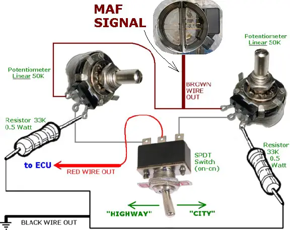

For those of you that want to, here is the schematic for the MAF enhancer that Al
uses.

well since aldive didn't help too much i ended up trying both "#4" and "#5" (at different times) #5 is the wire to use

EDIT: Ok i figured out how to install it. My final question would be about the actual build of the enhancer, why a 50 Ohm pot, I'm not too familiar with these concepts... sorry.
