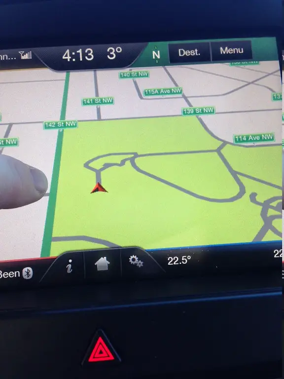

Frequently our navigation system shows our vehicle way off the road, in the bush, in a body of water & most definitely not on the street we're actually on. When driving in the city using the navigation is almost impossible because it's so confusing.

i have a half dozen pics on my phone of the exact same thing, putting me off into a mall or a park next to where i live (almost every time with the park...a good test of the system) when Im driving next to them.
