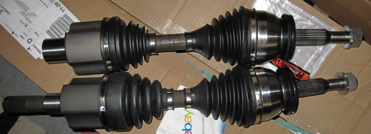

I also contacted TrackMotive, the only answer was to use the warranty if the boots will crack.
The OEM boots are very strong, never failed and they are much more longer as these
TrakMotive thermo plastik boots. But there's not enough space for longer boots,

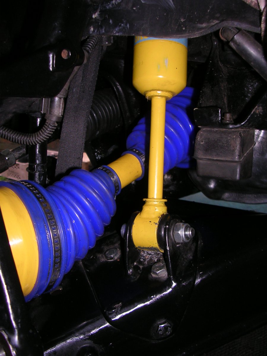

maybe silicone boots would be so soft and flexible for these extended travel axle.
I had tryed these silicone boots long time ago, but the OEM axles were worn and out of balance.

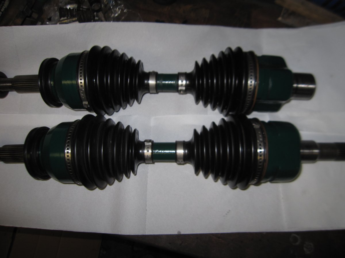

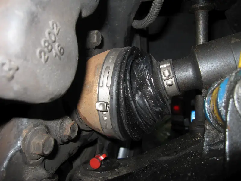

Painted , greased and sealed this used pair, but it last for only one year.
Clamps were not tight enough, grease came out...never ending story.
