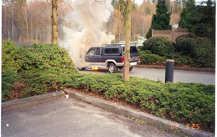

I did, it was a couple guys trying to prime their older carbeurated blazer with gas. I just happened to be there when it lit up. The guy had a container of gas that he dropped when it started, causing quite a show. Never try starting an engine whilst pouring gas in the carb, wait till you`re out of the way, then crank.
I just carry a small ABC dry chem, not sure how any pounds but it`s about the size of the average long thermos, or maybe 2 and 3/4 stacked beer cans, if that`s what you drink.
After I took a picture (well I had the camera right there) I ran up and put the fire out very quickly, those little extinguishers really hold alot of stuff, I only used 1/2 of it, and the fire was in the engine and on the ground underneath.

Here`s a couple picture examples, the first was the one I put out for these guys.
The second was a friend of mine who develeoped a fuel leak under the hood, at the fuel rail somewhere I guess. He always carried a camera with him, but a 20 dollar fire extinguisher would have had that fire out in a jiffy. His truck was a total loss as a result, there was nothing he could do. He started smelling gas as he was driving, and as soon as he stopped to have a look...whooomph.
It was after that that I got my extinguisher, if it happened to him...
