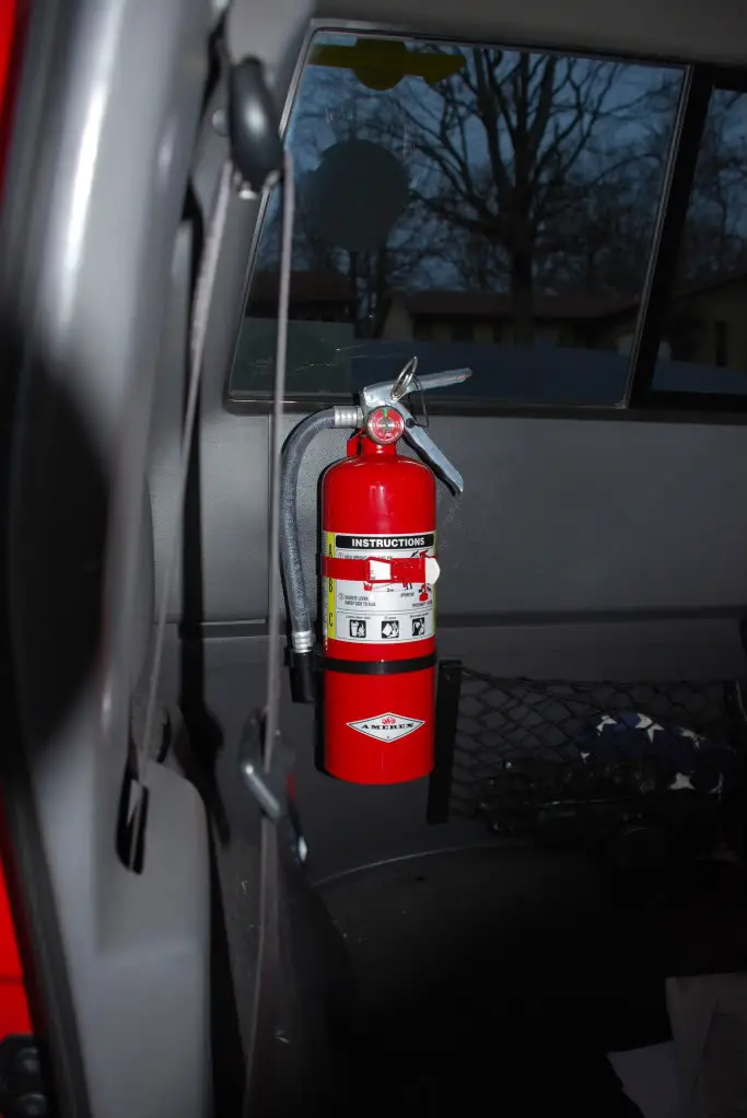

I keep two 10# ABC's at my house and a 10# in each truck. Not sure they will guarantee my safety but at least I have a chance. In your car it is VERY IMPORTANT to keep them out of the way of things accidentally setting them off or being mobile during a car accident. Don't want that thing clocking your head in a roll over!
