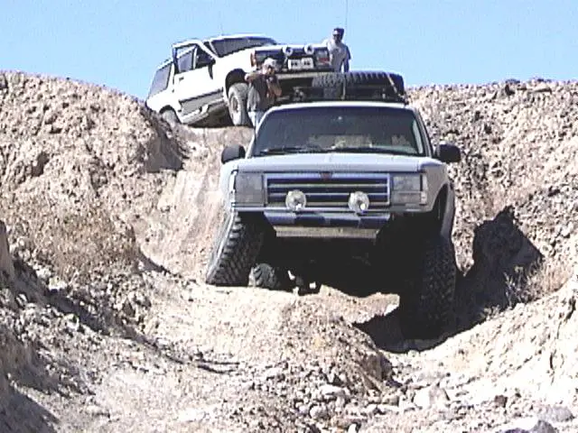

This is what you need. It's a '92 XLT with a 4" TrailMaster lift and 35s. I've got the Perry's fenders on it too. Good luck!
