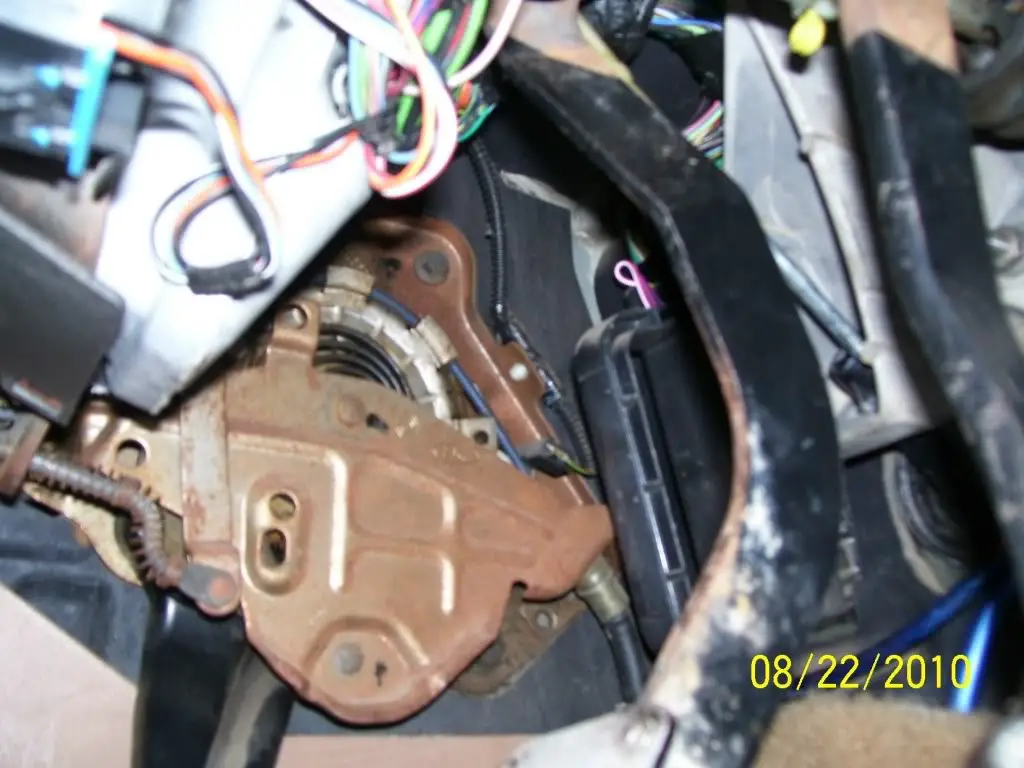

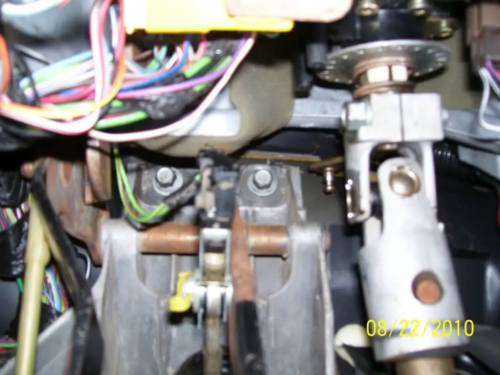

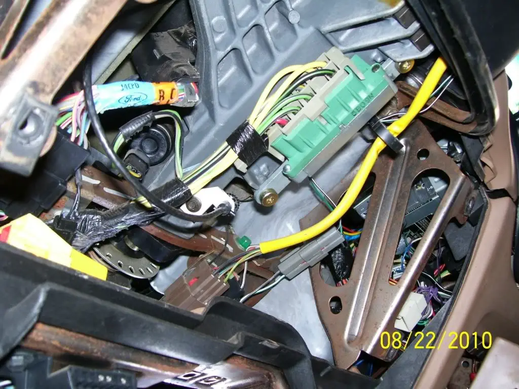

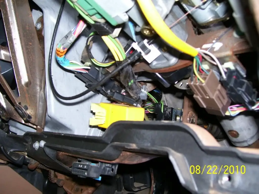

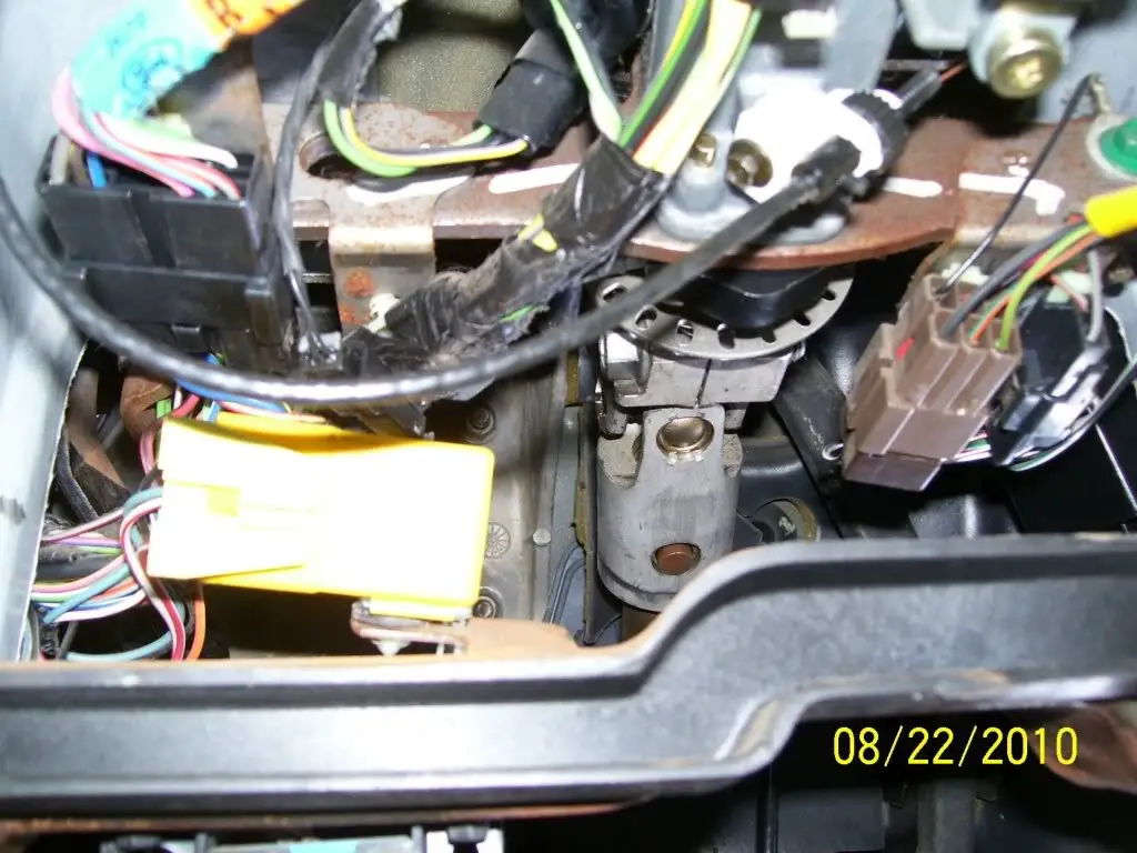

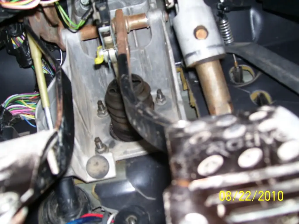

I went back at it for a little bit. I thought about the stock steering column shifter. I lowered the column from the dash, and removed the shifter itself. Thinking that the steering wheel would be locked in the park position, I placed it in Neutral first. All good right? Nope. I neglected to think farther down the road. I went to remove the key, it won't come out unless it is on Park...lol Whoops.
Thats when I called it a day. I will just live with the shifter in place, until I find a manual steering column for it.
