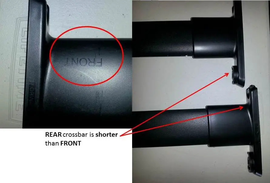

The installation instructions are ok, but they definitely could be better. There IS a front and rear crossbar as you can see in the picture.

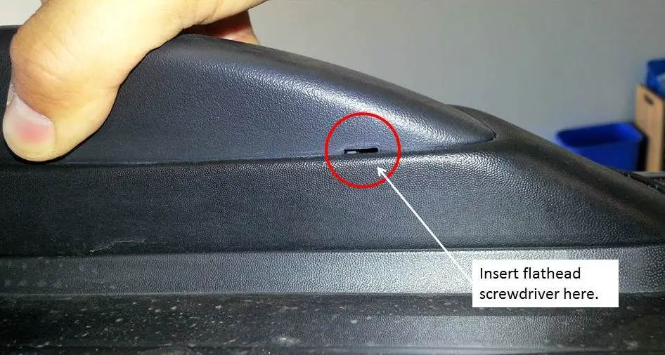

Then, using a flathead screwdriver, remove the rear covers to expose the track within cargo bars.

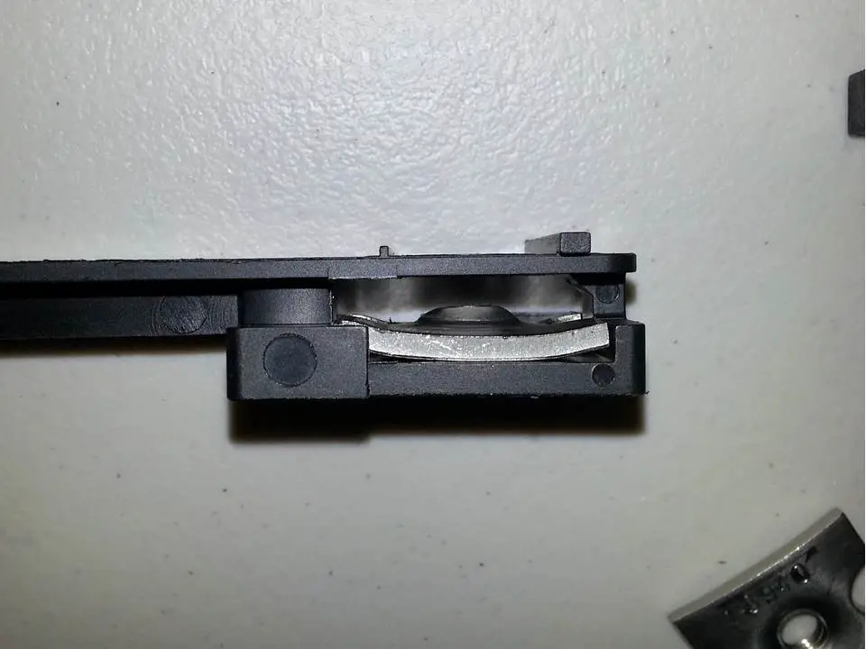

Next, install the metallic nutplate/clamp pieces into the mounting plates.

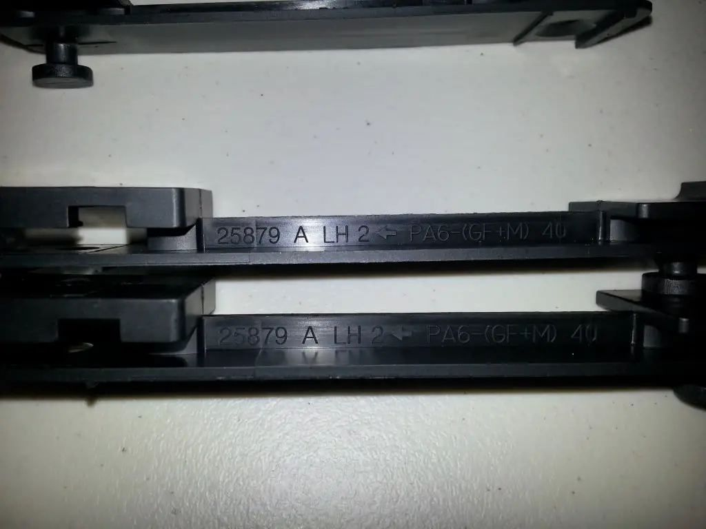

Then simply slide each respective crossbar mounts in the track. There are "left" and "right" side mounts, but not "forward" or "rear" specific mounts to each left or right side.

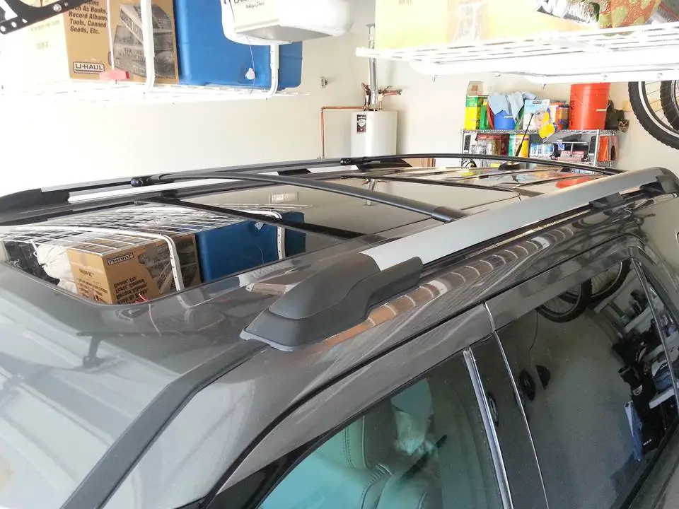

The finished product!
