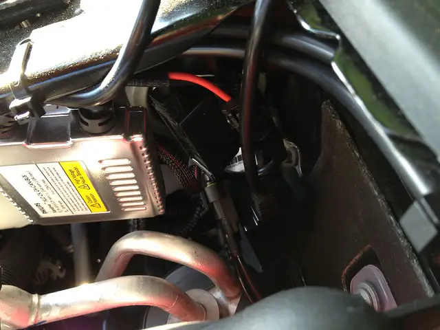

Here are a couple of pictures of my install. Not the neatest install in the world but I was anxious to get the lights in. I will probably go back one day and make it a little neater.
Pass Side
Driver Side
Dust Boot
Light Sensor - There are 3 sensors - 1 light and 2 sun sensors. Just cover the light sensor up with electrical tape and put everything back together. Location of light sensor is middle of dash by windshield.
