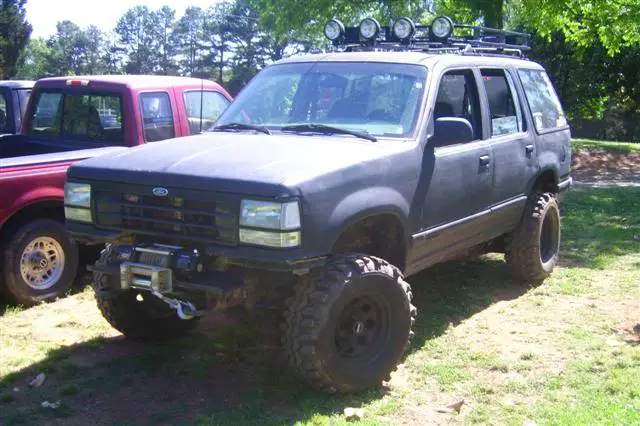

Found a set of nice clear headlights at the junkyard. Funny thing is the whole front end was destroyed on it in a crash except the headlights. Just on of the back backing pieces was broke all up so I just replaced it with one of mine. Worked fine.

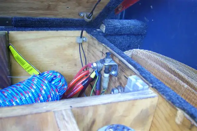

Put a light in my box and put a door switch on it.
Nite shaded the tails. Not sure if I like it or not though.
Overall shot of the front now.

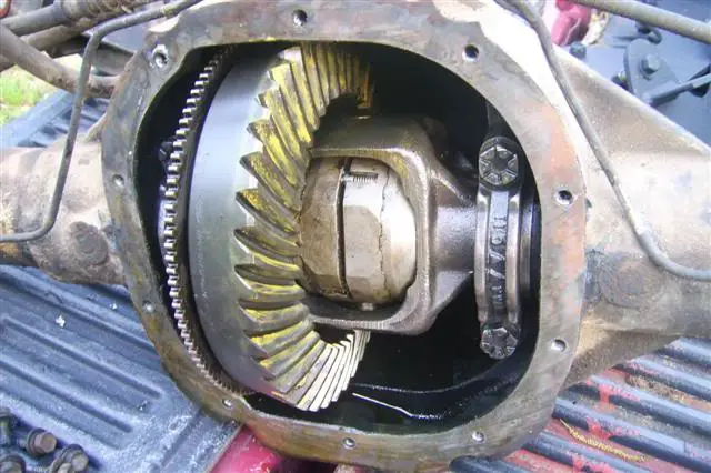

Getting everything ready for the lift install and diff swap. Ran into a problem putting the front air locker in could get the backlash right and found out it calls for a different bearing on one side so I got the right bearing for it this weekend so I should get it together this coming week. Made some guessets for the drop bracket.

Finished getting both my diffs put together today. Going to swap them out and swap lifts out starting tomorrow night and finish up Saturday if all goes well.
Front D35 with 4.56 and ARB
Rear 8.8 with 4.56 and Aussie

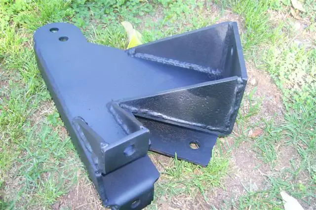

Finished getting the lift and diffs swapped out yesterday. Havent got the body lift taken off yet so it looks kind of goofy with 31's. There is actually a little negative camber so I will probably put the coil spacers back on the front and pull the body lift and see how it sits then.
Driver side f-250 brake line
Passenger side f-250 brake line
